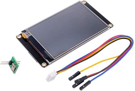

  • Nextion Display

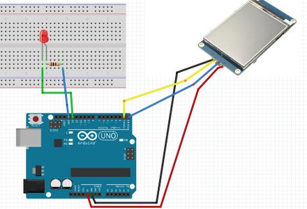

Step 2: The Circuit
  • Connect Nextion Display VCC red wire to Arduino 5V pin
  • Connect Nextion Display GND black wire to Arduino GND pin
  • Connect Nextion Display Yellow wire (RX) wire to Arduino TX pin
  • Connect Nextion Display Blue wire (TX) wire to Arduino RX pin
  • Connect LED positive pin to Arduino digital pin 13
  • Connect Resistor one end to LED negative pin
  • Connect Resistor other end to Arduino GND pin

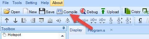

Step 3: Nextion Editor
  • Download Nextion Editor and Install it
  • Start Nextion Editor
  • In the Nextion Editor click on the "New" button
  • In the Window set the name for the Project like "LED"

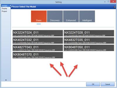

  • In the "Setting" window select the Model of your Nextion Display & click "Ok"
  • Select Display Direction 90 & click "Ok"
  • In the Editor on the left in the "Toolbox" find "Dual-state" button & drag it to the right
  • Center & Resize the Button

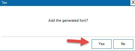

  • In the Menu click on the "Tools" > "Font Generator"
  • In the "Font Creator" window set size to 64 and set the Font name & click "Generate Font"

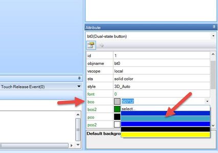

  • Select the Button
  • In the "Attribute" window set "BCO" to Blue color

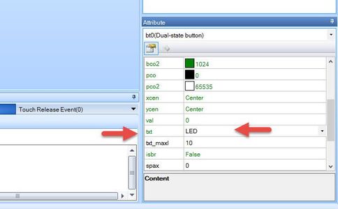

  • In the "Attribute" window set "txt" to LED

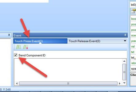

  • In the "Event" window > Touch Press Event" Check the "Send component ID"
  • In the "Event" window > Touch Release Event" Check the "Send component ID"
  • In the Toolbar click on the "Compile" button

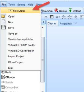

  • In the Menu Select "File" > "TFT File Output"
  • Set the Output folder & click on the "Output" button
  • Save the File to the SD card
  • Insert the SD card to your Nextion Display
  • Power the Arduino and you will notice that the Nextion Display will start to Update it self
  • On the Finish disconnect the power and remove the SD card from the Nextion display

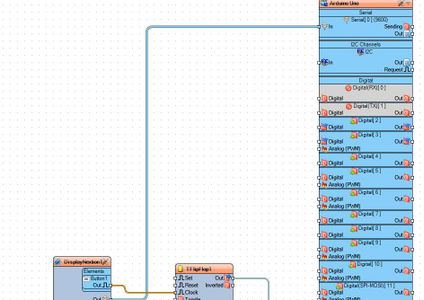

Step 5: In Visuino Add, Set & Connect Components
  • Add "Nextion Display" component
  • Add "Toggle Flip Flop" component
Toggle Flip Flop will act as a swith, on each clock pulse the output will be once True or False

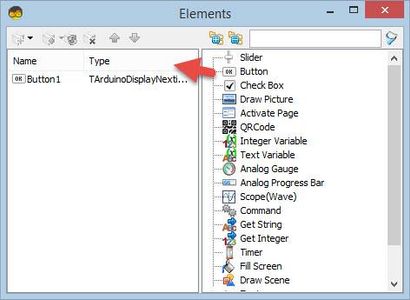

  • Double click on the "DisplayNextion1" And in the Elements window drag "Button" to the left side.
  • And close the Elements window

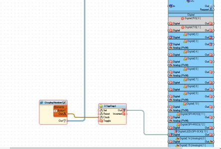

  • Connect "DisplayNextion1" pin out to Arduino Serial pin
  • Connect "DisplayNextion1" > "Button1" pin Out to "ToggleFlipFlop1" pin Clock
  • Connect "ToggleFlipFlop1" pin out to Arduino digital pin [13]
Before Uploading Disconnect RX pin
and
After the Upload Connect the RX pin back
