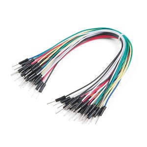

  6. Jumper wires

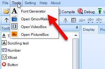

  2. In the Menu select "Tools">"Font Generator"
  3. In the Font creator window set the "Height" to 40 & set the name for your font and click "Generate Font", Save the Font, you will be asked "Add the generated font?" Click Yes

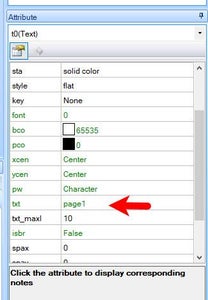

  4. In the Editor on the left in the "Toolbox" find:  "Text" & drag it to the right and in the properties set "txt" to your desired text

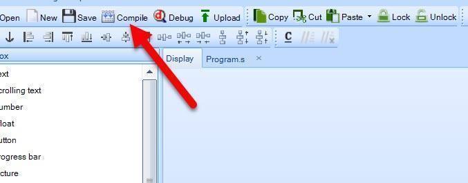

  1. In the Toolbar click on the "Compile" button
  2. In the Menu Select "File" > "TFT File Output"
  3. Set the Output folder & click on the "Output" button

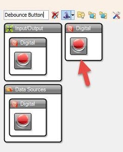

Step 4: Start Visuino, and Select the Arduino UNO Board Type
Start Visuino as shown in the first picture Click on the "Tools" button on the Arduino component (Picture 1) in Visuino When the dialog appears, select "Arduino UNO" as shown on Picture 2

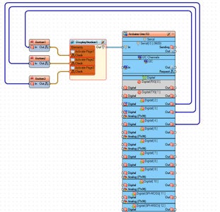

  1. Add 3X "Debounce Button" component
  2. Add "Nextion Display" component

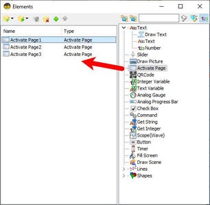

  3. Double click on the "DisplayNextion1" And in the Elements window drag "Activate Page" to the left side and in the properties window set "Element Name" to page0
  4. drag another "Activate Page" to the left side and in the properties window set "Element Name" to page1
  5. drag another "Activate Page" to the left side and in the properties window set "Element Name" to page2
  6. Close the Elements window
  1. Connect Arduino digital pin [2] to "Button1" pin [In]
  2. Connect Arduino digital pin [3] to "Button2" pin [In]
  3. Connect Arduino digital pin [4] to "Button3" pin [In]
  4. Connect "Button1" pin [Out] to "DisplayNextion1" > "Activate Page1" pin [Clock]
  5. Connect "Button2" pin [Out] to "DisplayNextion1" > "Activate Page2" pin [Clock]
  6. Connect "Button3" pin [Out] to "DisplayNextion1" > "Activate Page3" pin [Clock]
  7. Connect "DisplayNextion1" pin [Out] to Arduino serial pin [In]

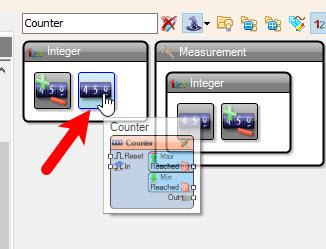

  1. Add "Counter" component and in the properties window set "Max" > "Value" to 2 (Number of pages 0 to 2) and "Min"> "Value" to 0
  2. Add "Clock Demux(Multiple Output channel Switch)" component and in the properties window set "Output Pins" to 3

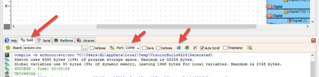

Step 7: Generate, Compile, and Upload the Arduino Code
Before Uploading Disconnect RX pin on Arduino and connect it back after the Upload.
In Visuino, at the bottom click on the "Build" Tab, make sure the correct port is selected, then click on the "Compile/Build and Upload" button.
