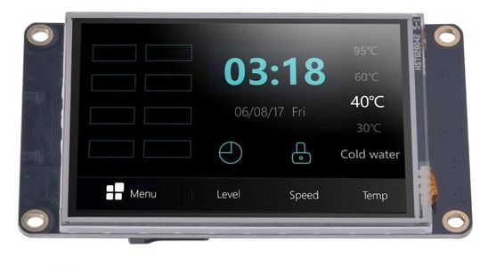

The original Nextion Arduino library requires hardware serial. I will show you how to use the Arduino SoftwareSerial instead. This is handy for troubleshooting.

SoftwareSerial myserial(8,9);  // 8 goes to Nextion TX, 9 goes to Nextion RX
EasyNex myNex(myserial);
The remaining of your code are the same as when you use the HardwareSerial. That's it and enjoy. Now you can use the HardwareSerial for debugging.
