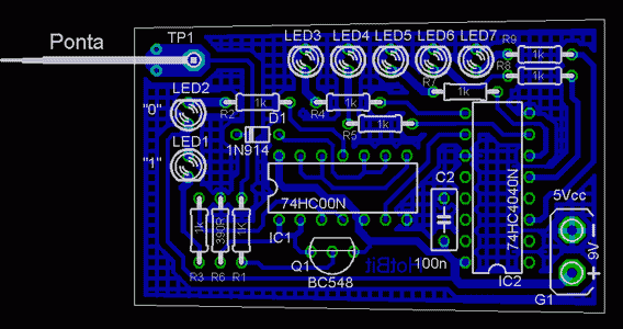

Introduction: Nice Looking Component Side Preview for PCBs
This instructable will teach how to make a nice looking image of the component side of your printed circuit boards made with Cadsoft's EagleEagle. The process can also be easily adapted to other PCB Cads. The software tools needed are:

Comparing the crude looking of the original green/blue/white image with the sharp look of the
salmon/white image one can see that it worths the effort!!!

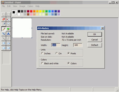

Open MSpaint and open the Attributes window by typing Control+E or by clicking in Image->Attributes. Change Width and height of the image so it's smaller than the board image. A 100x100 pixels is a good start.
Now type Control+V or go to Edit->Paste to paste the board image to MSpaint workspace. The Workspace now was resized to the Board image size.
