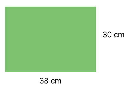

You can use a 30 x 38 cm board, but this will be up to you as to how big your project will be with all the trimmings. Then you must screw the 20 cm slats, in my case I used 2 forming a "T". You could use one depending on its thickness and whether it is capable of supporting the DC motor.

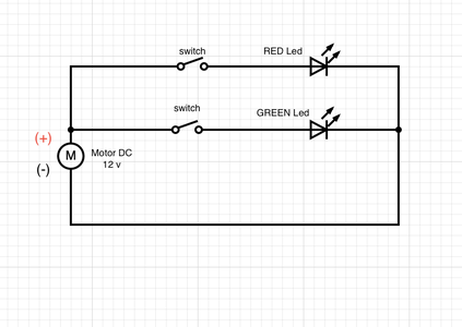

The electrical circuit in the image is quite simple. We will connect the negative pole directly to the negative of both LEDs. We will pass the positive pole through 2 switches to control the switching on of the LED that we want to make shine.
We could think about using an electrical resistor for each LED, but I decided against it, since the brightness dropped quite a bit, perhaps I didn't have the right resistor. Anyway I made sure to check the voltage generated and we managed only 2.1 Volts maximum.

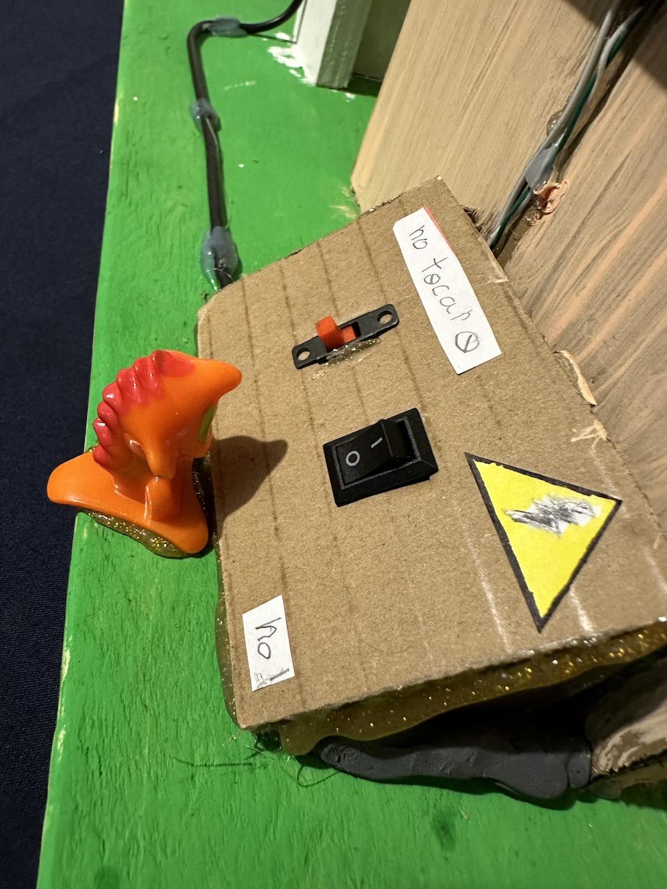

I did this school project with my daughter, we had a lot of fun checking out the benefits of wind energy. She quite enjoyed running this with a hair dryer (cold mode so as not to melt and destroy our propeller) and watching the LEDs she selected light up. It is important to consider that when selecting both LEDs, they will shine less.
She decided to make a house and decorate it with her mini friends "Star Monsters", assuming that they are the workers of the electricity generation plant. I must say that she always has great ideas.
