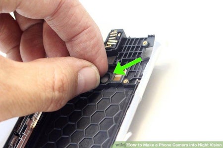

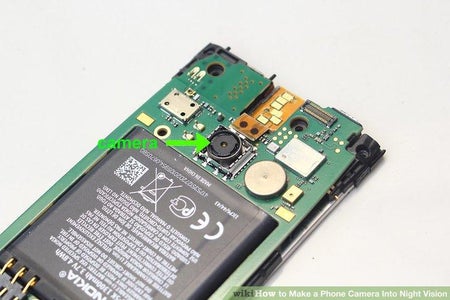

Every model will be different but you want to take something flat and sturdy and wedge it around the sides where the screen meets the housing. I wouldn't recommend doing it near any plugs or buttons if you can avoid it. Once its open find your camera and then GENTLY twist the top part of the camera off exposing the IR filter. Once its exposed VERY GENTLY!! remove it. Be very careful not to scratch or damage the lens(I was not this careful as you will later see. Once its removed screw the top back on and reassemble the tablet

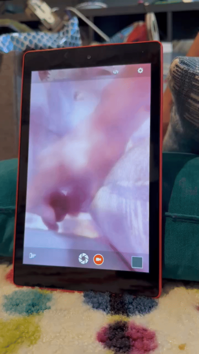

Go to your camera app and test to make sure your camera still works, if you can see clearly out of it with no spots, CONGRATS! You did it. I was not this fortunate so you can see little dark spots but it will still work! Find a TV remote you know works and press buttons while it faces the camera. If you see a little blueish flash, its working!

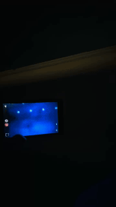

Go to a dark room or wait for night and test your camera! The little dots in the recording are LIDAR from the phone I recorded it on. You can also play around with face id using this camera but that's a rabbit hole I'm not going into.
