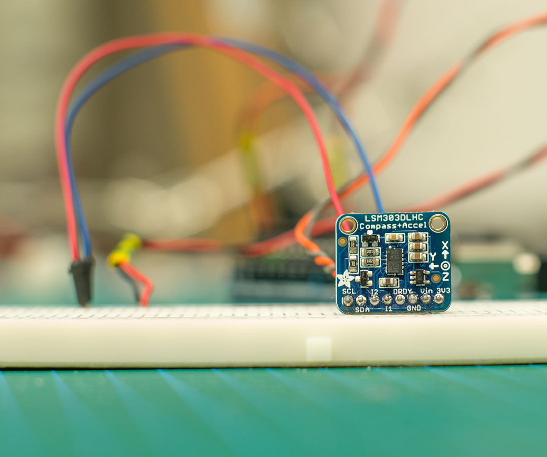

The Night Sky Explorer uses a LSM303 sensor that orients its position on Earth and movement in a space. For a detailed introduction to this central component of the project, check out this explorative instructable of the LSM303 (https://www.instructables.com/id/LSM303DLHC-explora...).
By going through this instructable, you will get to know how to wire up the LSM303 to an arduino, which is all the physical components you will need, in addition to a pocket projector. This project made use of a Pico projector from Optoma, but any other would do. Also, if you don’t care about the size, an ordinary projector will also do the job. Optionally, but recommended for stability, it is a good idea to assemble all the components to a tripod.
Step 2: Assembling
The LSM303 sensor needs to be placed in acertain distance from all other traces of metal or magnets. If not, this will cause disturbances in the readings and errors will occur. This is why you should use wires of a certain length as a buffer to keep the sensor at a safe distance.
