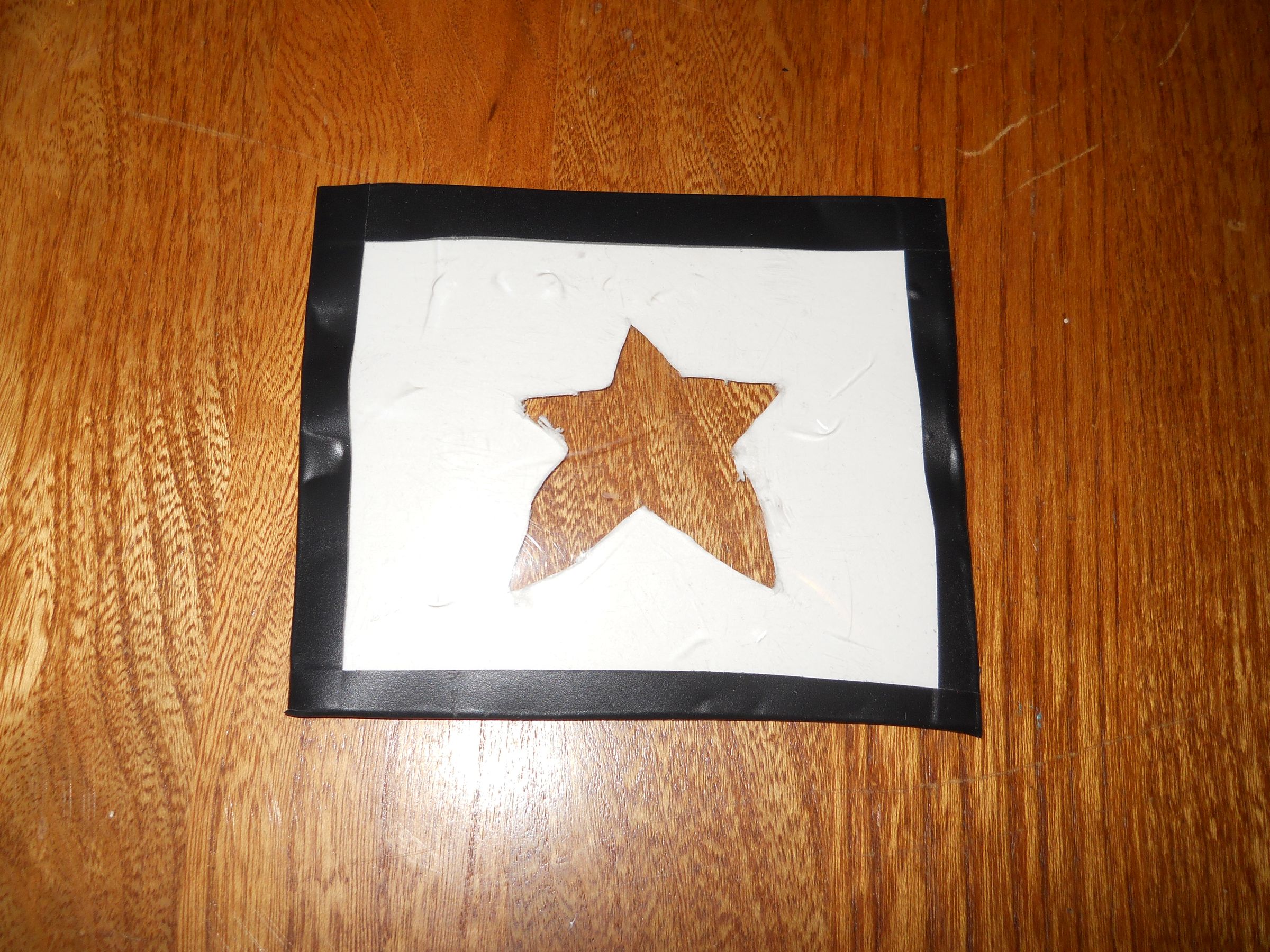

This is a simple project I made not long ago. It looks nice, is simple to make, and will light up a room. Materials: Craft_sticks 1_LED Rocker_switch Button_cell_battery_holder NightLightProjectorLens (this can be made from my other instructable) Wire A_button_cell_battery_that_fits_your_holder Craft_glue Solder Electrical_tape Tools: Hands Drill Soldering_Iron
