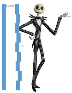

For visibility and to protect from theft, I have as much as possible on my porch and (flat) roof. I used Powerpoint to plan a layout for the display and to determine the proportion of Jacks limbs, head, etc. More specifically, I measure each part in pixels then multiply out to get the desired height in feet. Jack ended up just short of 10’ tall (plus the length of pipe that’s not seen but used to secure him). Sally is pretty tall too; if she were standing she's be over 6 feet.
Step 3: How to Make Jack Skellington
Carve and paint his head
I carved Jack’s head – and several other characters/elements – from rigid wall insulation. I glued layers of foam together with foam adhesive – be careful, many adhesives and sprays will eat through foam – and allowed the glue to set-up for 24+ hours. I decided both Jack and Sally’s heads would be about 11.5 inches in diameter so I made a C-shape (like giant calipers) from scrap wood. I roughed-in the spherical head with a hacksaw and drywall saw before I moved to an extendable blade shop knife and surform shaver. Jack’s head is much more squat than a sphere, so I carved the base of his head to be more flattened and made a slope from a short nose up his forehead. I carved his eye sockets, nostrils and mouth using a Dremel rotary tool with a drywall cutter attachment. I then sanded the foam to smooth some edges, spackled with lightweight wood filler (I like DAP premium), sanded, spackled, etc. until totally smooth. I then applied two coats of white latex wall paint I had on hand to cover all exposed foam. Black acrylic paint were used to paint the mouth and nose and a gradient of colors – black to medium grey – were used to add depth to the eye sockets. I used a hole cutter drill attachment to cut a hole in the base of the head to insert a PVC pipe “neck”. I had a snug fit but you might use some foam adhesive within the head to help anchor it if needed. I patched any rough spots around the hole and painted both the base of the head and the PVC (so it’s not shiny). Once everything was painted, I used matt clear coat to seal the paint. Be aware that spray paint – even clear coat – will eat through exposed foam so make sure all foam is covered before applying clear coat.
Build his body
I made his body from 2” PVC pipes and his joints were made from two layers of 3/4" oak. For strength, I wanted to use a hardwood and I layered the two pieces of wood with the grain running in different directions and attached them with screws and glue. I then trimmed the oak joints on my bandsaw (setting the platform at an angle) so they fit snugly inside the PVC. I made 5 wood pieces – shoulders/neck, pelvis, two elbows and one knee. I chose to have one of his legs straight to make the structure more solid once he was standing. When cutting the PVC for the legs, I included an extra two feet at the bottom to be used for securing the structure. In my case, this was behind the parapet wall on my flat roof but you could sink the PVCs in a hole in the yard or somehow hide the braces used to keep him upright. I used foam to make a triangular torso and a cylindrical midsection to add a little thickness to his body.

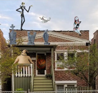

Step 10: Install and Light
Jack
I used a wooden box (sort of like a table structure) to be Jack’s base as it was hidden from view by the parapet wall. I cut holes in the top of the box so that the PVCs could pass through this layer and rest on the lower level of wood. I cut 8 pieces of ~1 inch thick wood with triangle/half-circles cut out of them and used these to pinch the PVC pipes to hold them tightly. These pieces were held in place with screws and the box was weighted down with extra lumber and a 25 pound plate. I also sank on long screw into the wood used to make Jack’s pelvis. To this, I attached 4 guide wires which were each anchored about 10 feet away. To tighten the wires, I used zip tie loops like turnbuckles (see picture).
Gravestones
I used 1/2" wood planks with screws and washers to clamp onto the gutter braces. To these anchors, I screwed the 2x4 bases of the gravestones. I wouldn’t recommend placing a lot of weight on the gutter but this wood/foam is pretty lightweight. For added stability in the wind, I attached wires to the tops of the gravestones with 3” screws and secured the other ends of the wire to the roof via other gutter braces. Just in case with wind knocks down the gravestones, these wires will keep them from blowing away.
Oogie Boogie’s lair
To contrast Oogie Boogie’s glow, I covered the porch in black felt that was stapled (using a staple gun) into place. Each piece was hot glued to the other and I cut flaps to allow wind to pass through (for the part that was not hung tight to the façade of my house). Oogie was secured to the railing with a loop of galvanized wire around his middle. His arms were kept lifted with black string stapled to the ceiling. The bats were also stapled to the ceiling and the spinning dice were hung with cup hooks. The lair was lit with an LED black light floodlight which worked very well.
Sally & cat
Sally and her cat were both secured to a wooden structure (left over from a Christmas decoration) which was hidden from view by the parapet wall. The cat was backlit by a floodlight sitting on the roof.
Jack-o-lanterns
To discourage theft of the pumpkins, I cut a disc of 1/4" MDF (any hard material would work) to place inside the pumpkin which was then screwed, through the bottom of the pumpkin, into the wooden step below. If someone wanted to take the pumpkins, they could but this might slow them down enough to hopefully make them reconsider.
