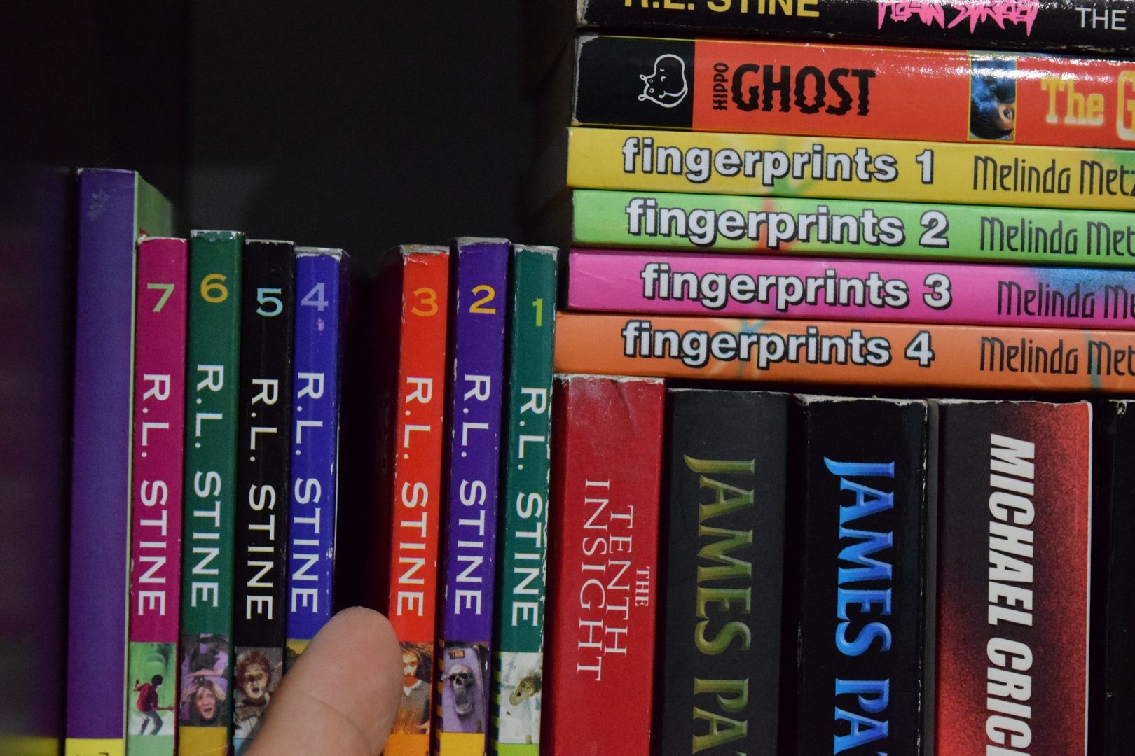

Halloween is coming. Just realized that I have so many horror books. Yes, I love R.L. Stine so much. Being left by my wife and kids at weekend, I dream of these Nightmare Room series keep falling from the shelf. Are these books really haunted? Or is it the room?

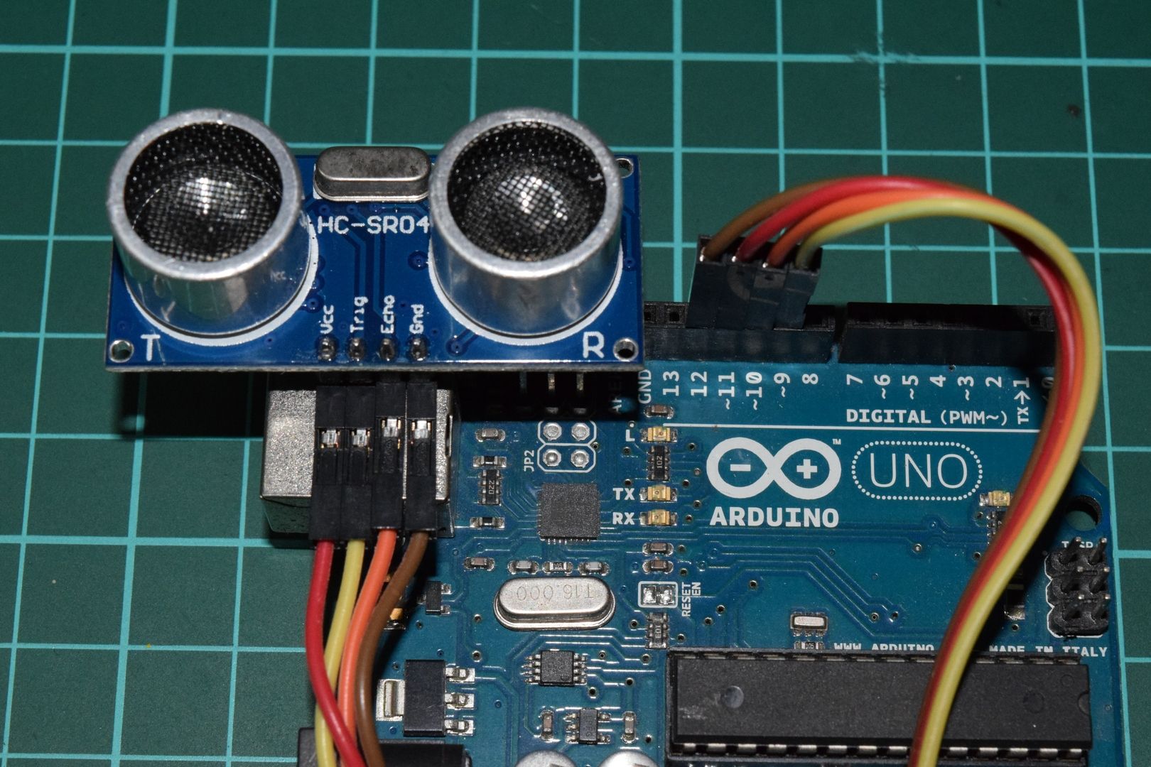

- HC-SR04 Ultrasonic Sensor.

Step 2: Wiring Ultrasonic Sensor

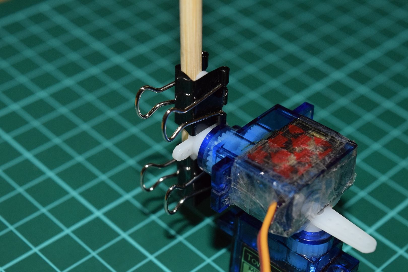

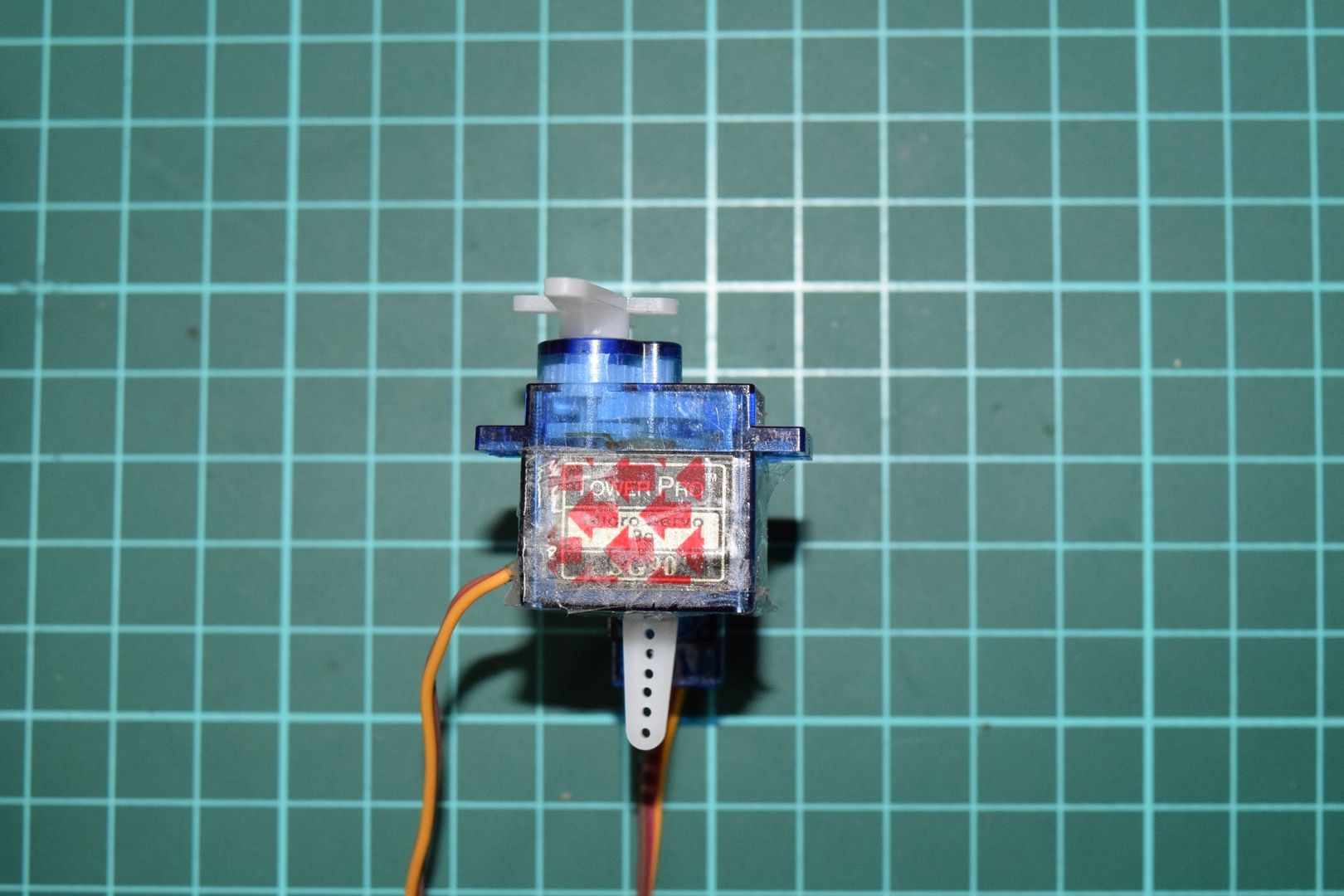

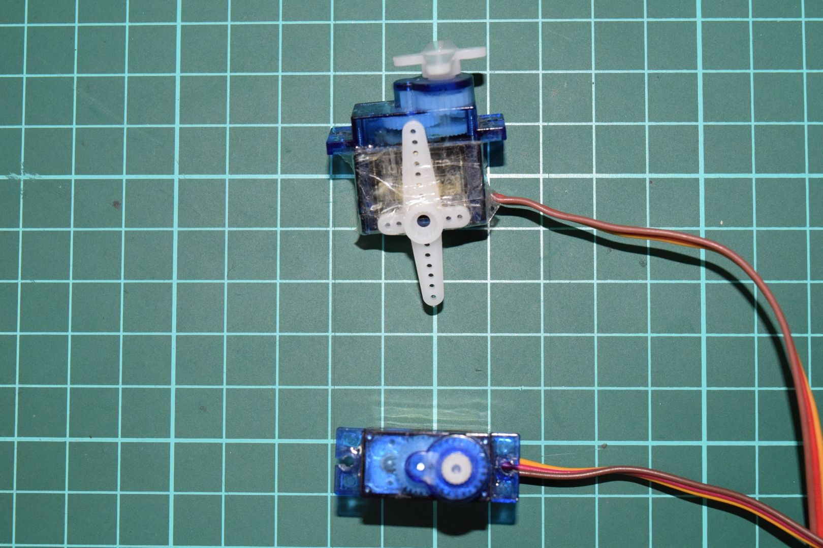

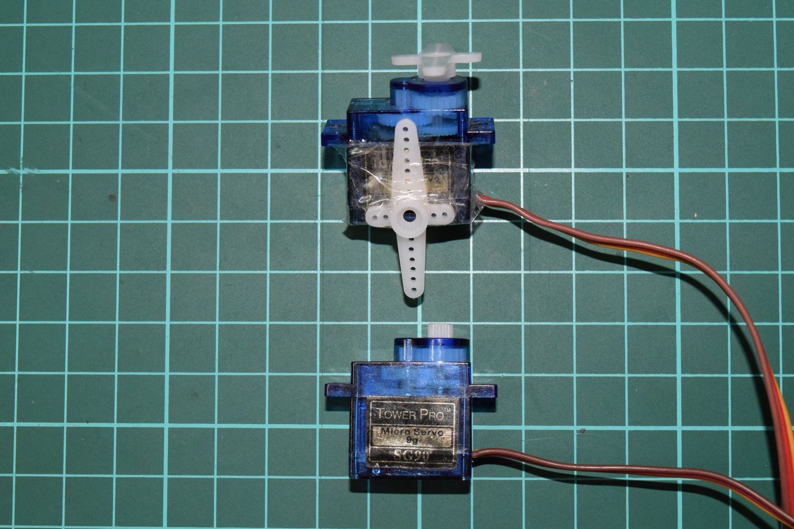

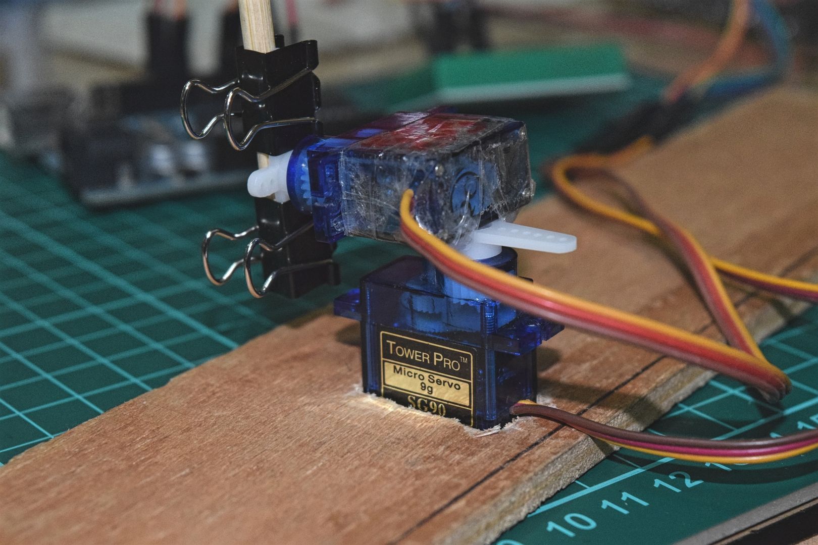

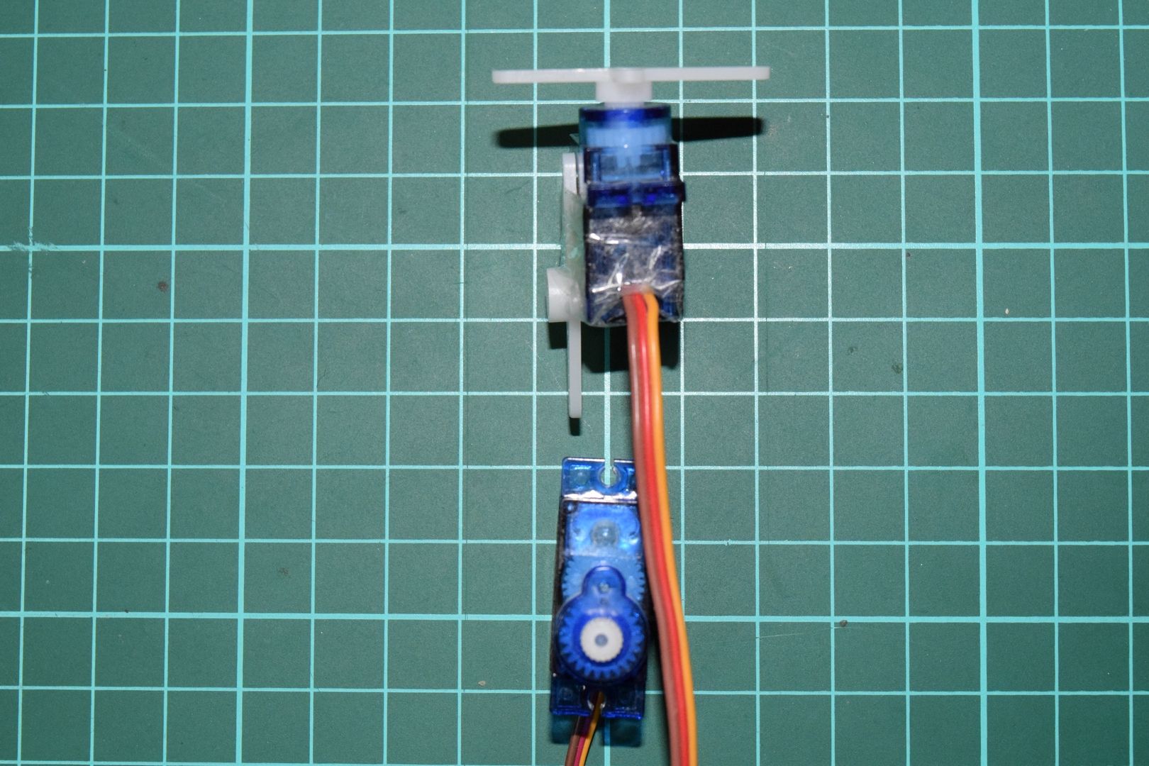

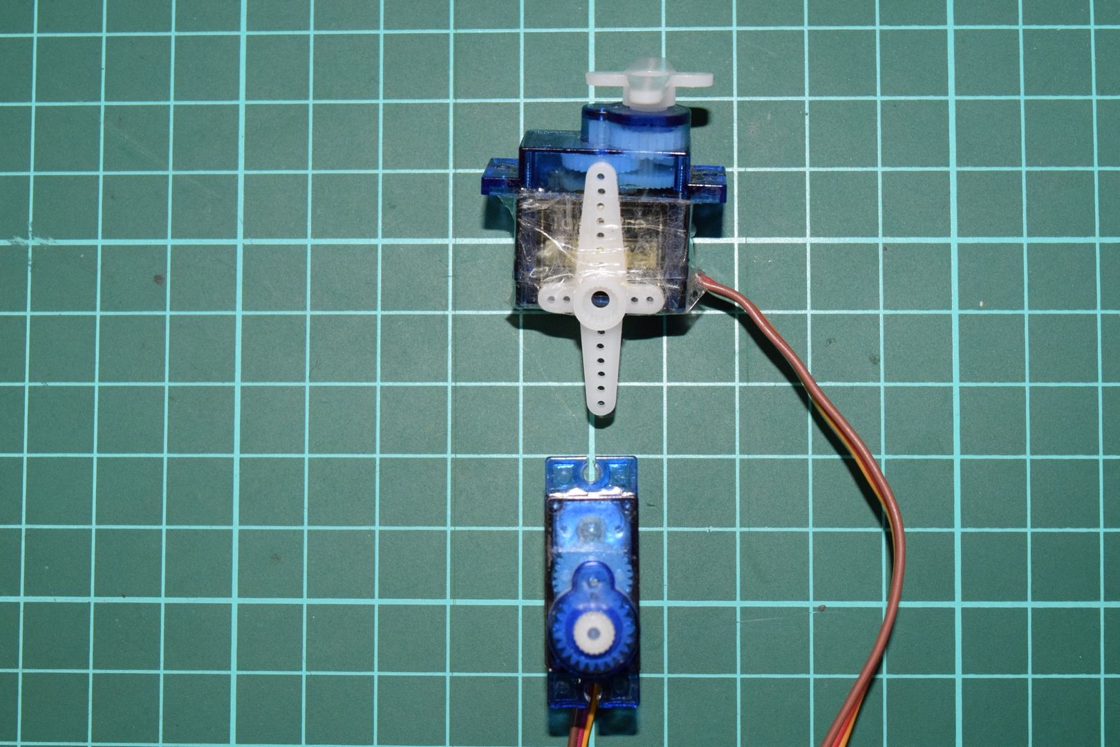

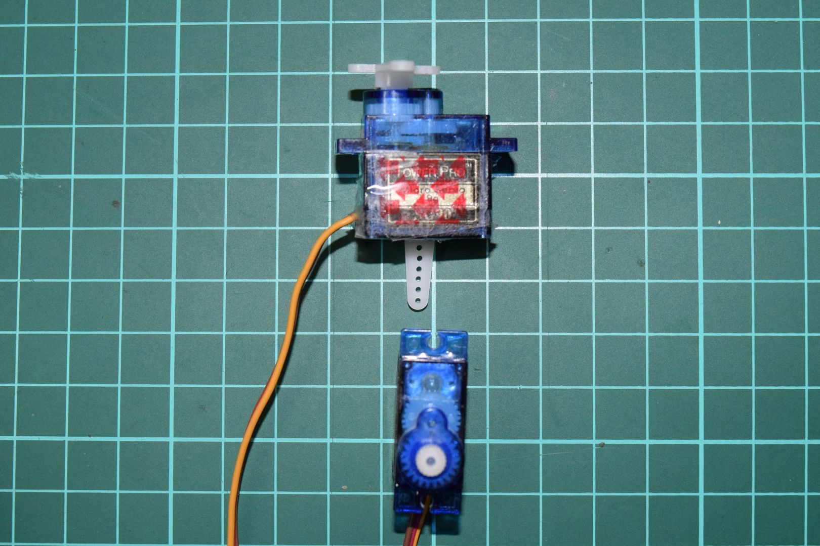

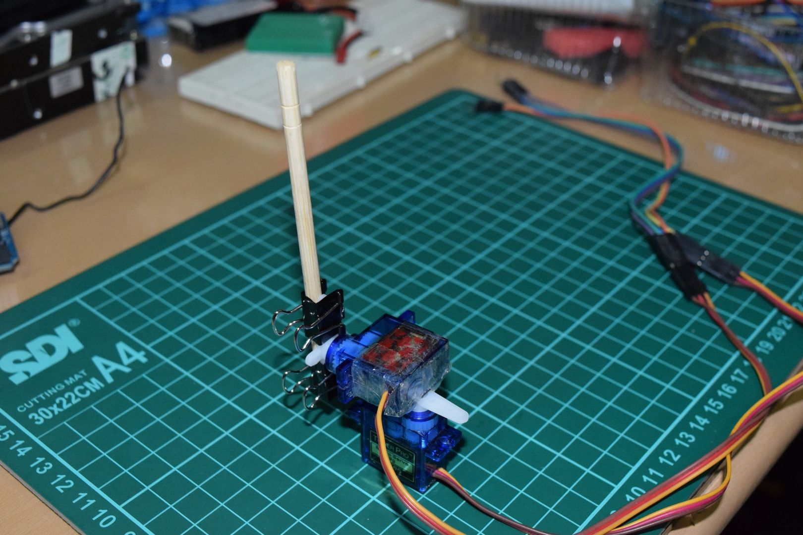

This is how I setup the servos. I call it the lower servo and the upper servo.
- Follow the position of image #1 to #6.
- Pick appropriate servos' horns.
- You can stick the lower servo's horn to upper servo's body by using adhesive tape or hot glue.
- Picture #1, #2 and #3 are about positioning the lower servo.
- Picture #4, #5 and #6 are about positioning the upper servo.
- Use binder clips or hot glue to clip the chopstick on upper servo's horn as in picture #7 and #8 below.

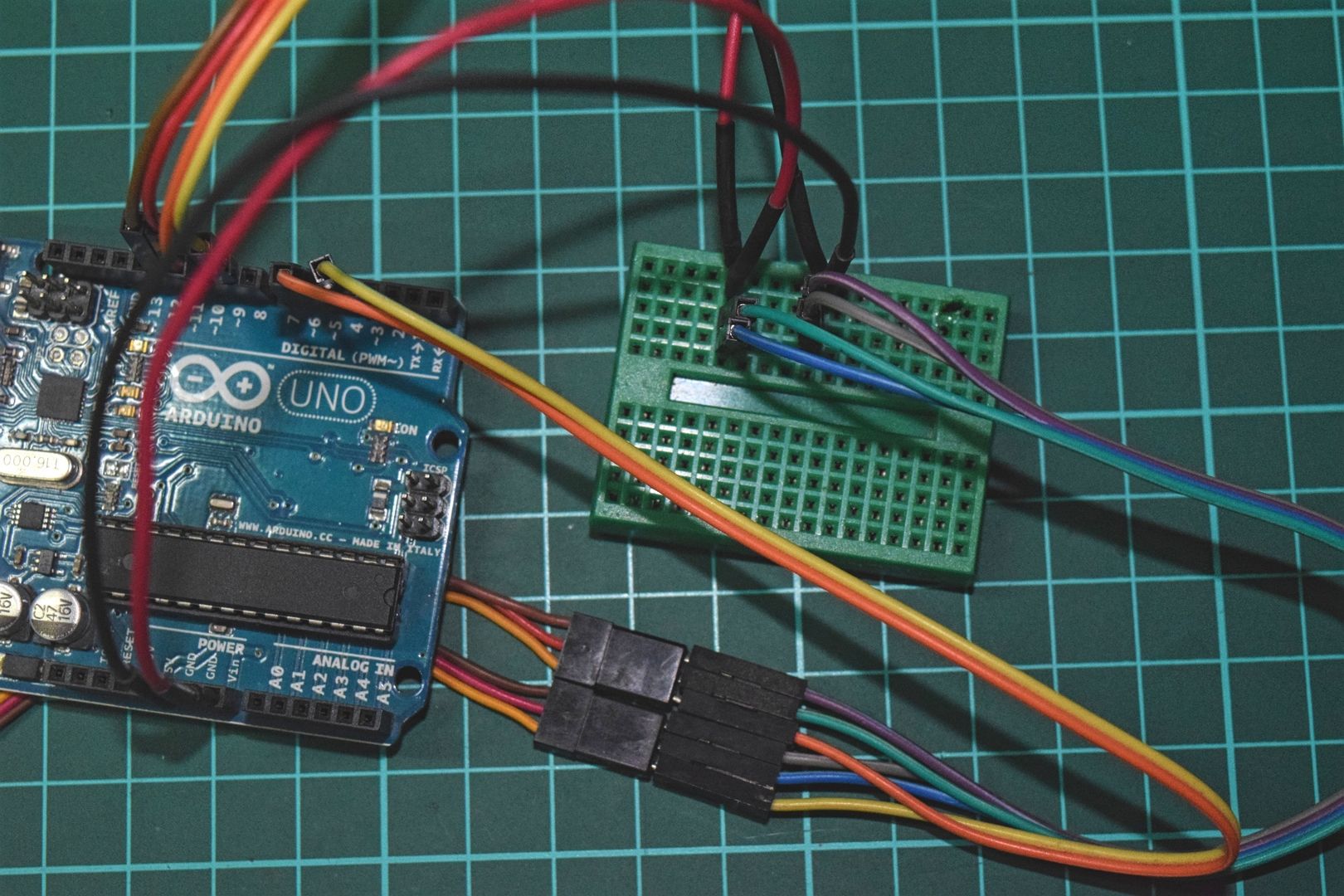

Step 4: Wiring the Servos
Refer to image and jumper wires' colors. Read these table per row.
Lower Servo | Upper Servo | Arduino | Power + | Power - | Color |
Brown(Gnd) | Breadboard - | Grey | |||
Red(Vcc) | Breadboard + | Blue | |||
Orange(Signal) | D5 | Yellow | |||
Brown(Gnd) | Breadboard - | Purple | |||
Red(Vcc) | Breadboard + | Green | |||
Orange(Signal) | D6 | Orange | |||
Vin | Breadboard + | Red | |||
Gnd | Breadboard - | Black |
Last thing to do is connect Breadboard + to Battery + and connect Breadboard - to Battery -
Step 5: Servos Stand
Mark the lower servo's base on a piece of plywood and cut a hole for the servo to sit in. Before doing this, measure where you want the servos sit on your shelf. You can simply stick the servos to the shelf with hot glue without using plywood. This project is temporary and hot glue is easily removed.

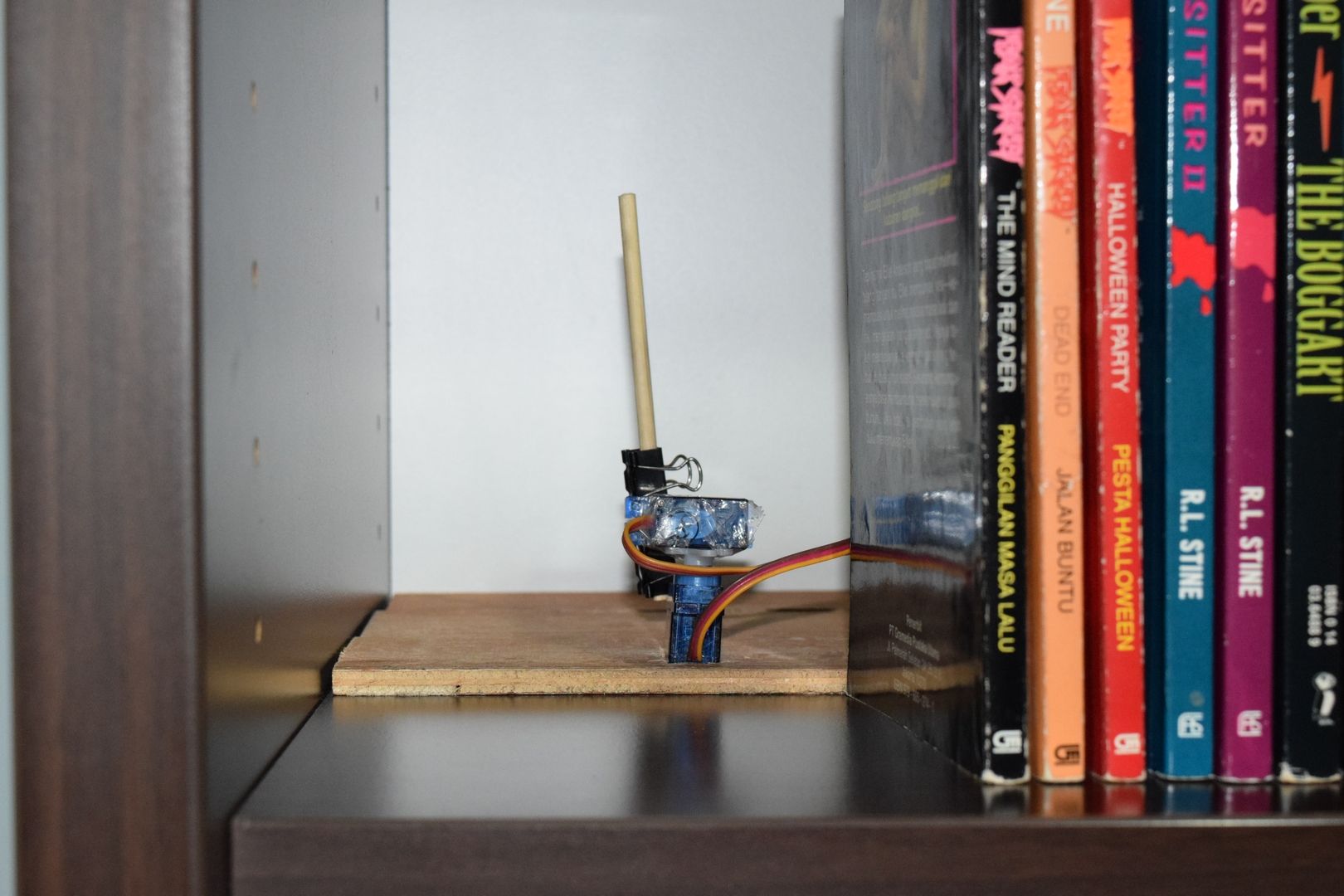

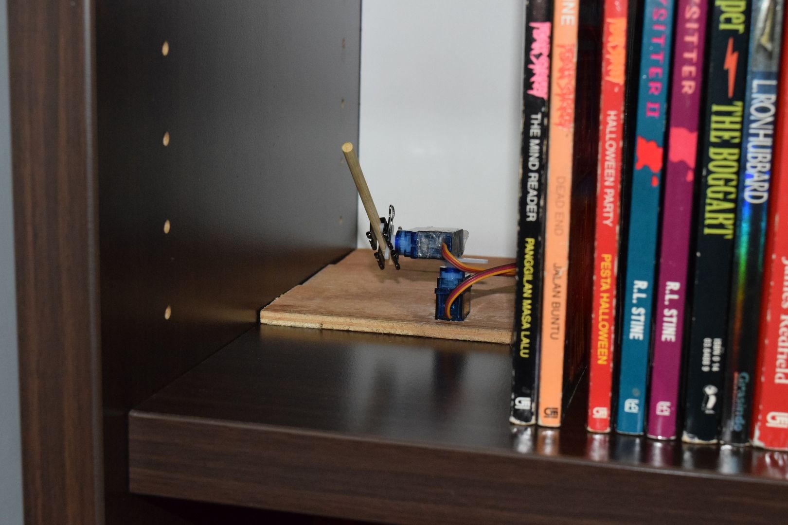

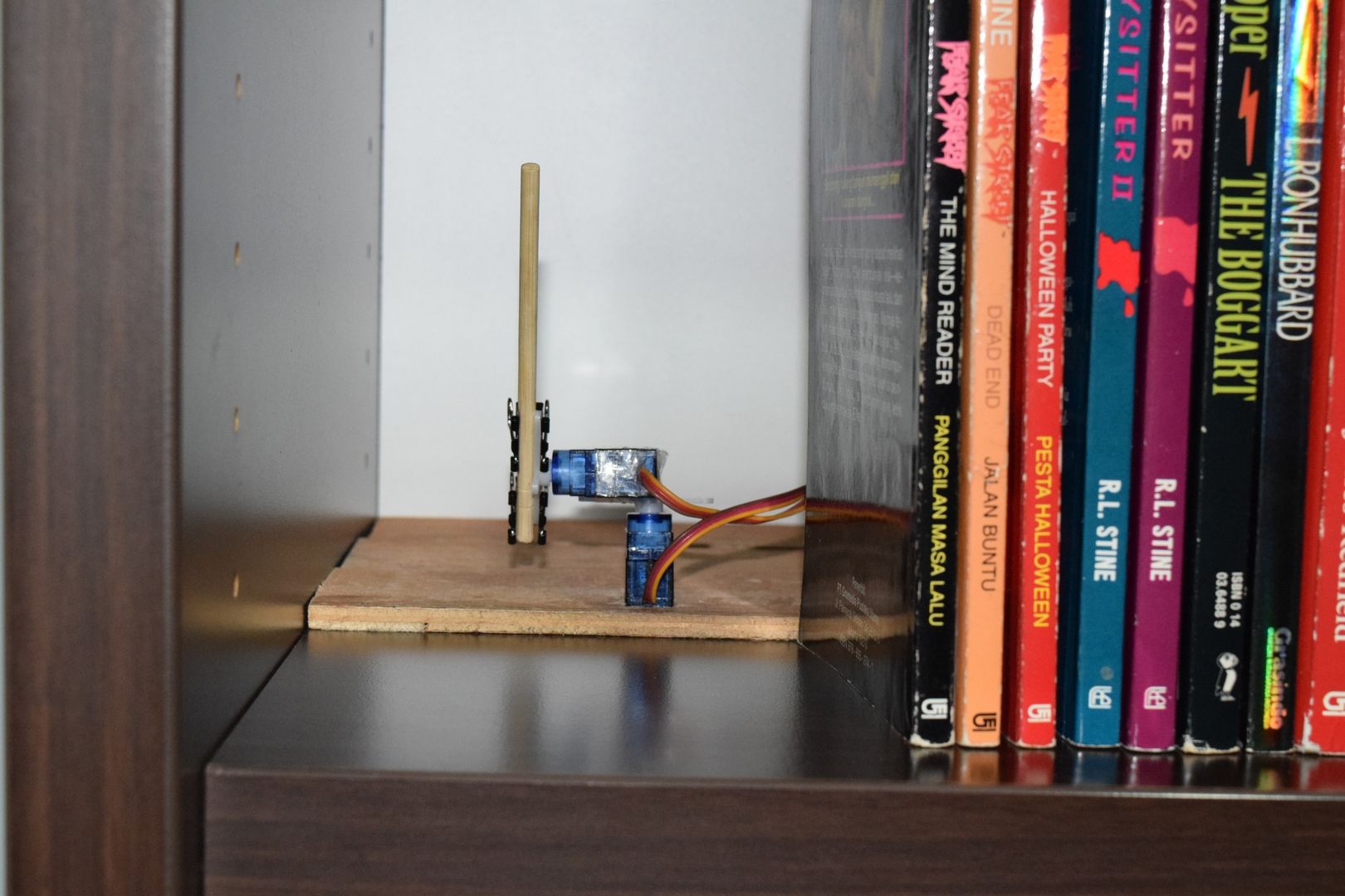

Step 7: Set Up the Shelf

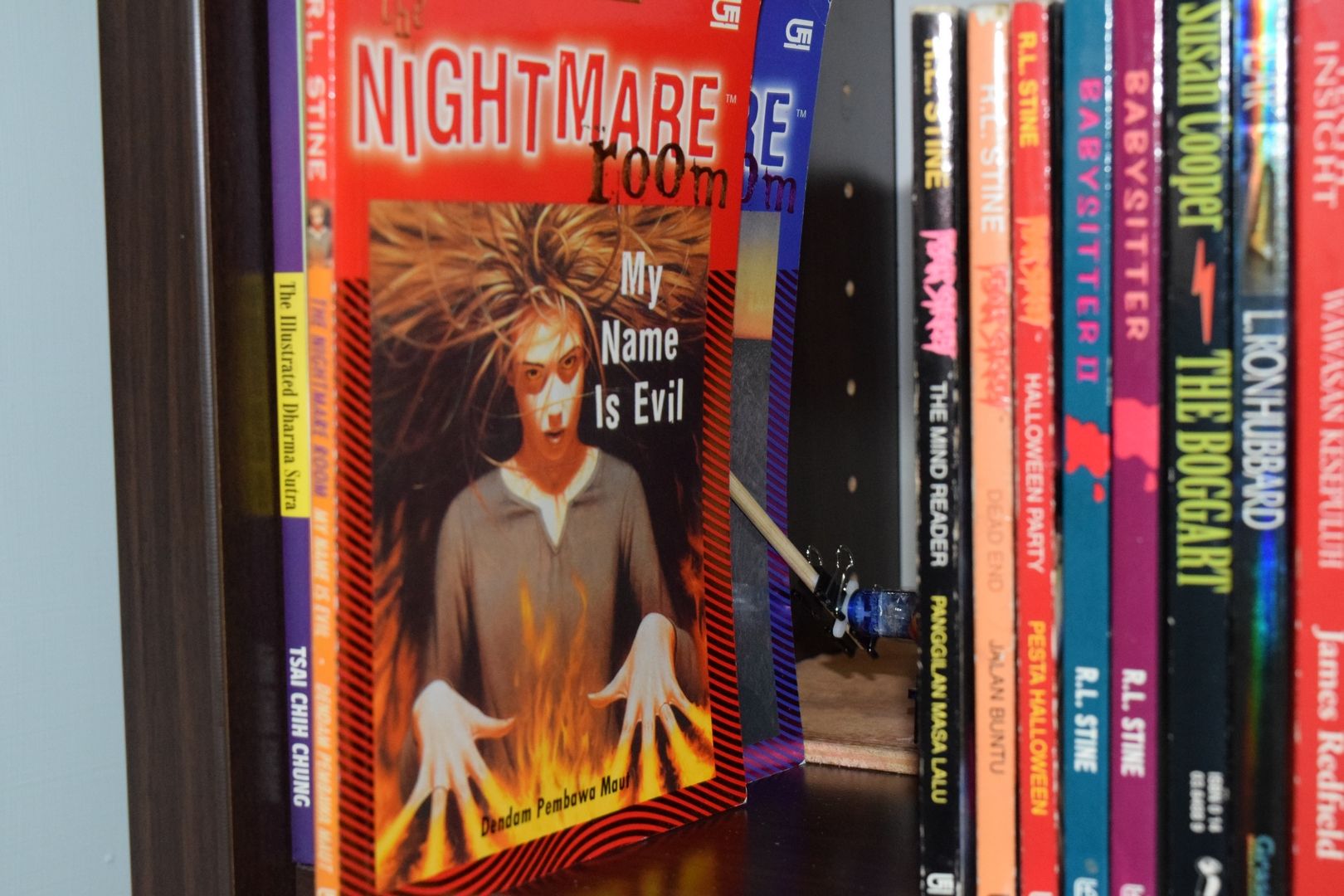

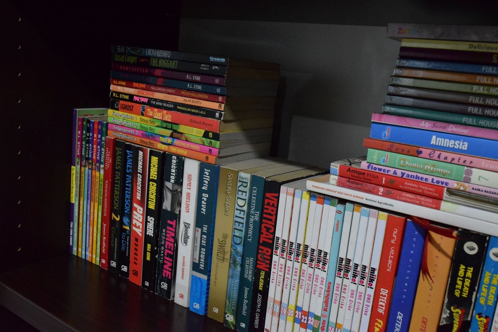

- Give room to your gadget by moving the books forward, next to the edge of the shelf. This is crucial not only giving room to your gadget but also to make sure the book fall down and not only moved out from the line.
- Place your gadget behind the book. Make sure the base sit well. Put something heavy on the plywood. Then test the servos's horns on their pushing position.
- Put your books back on the shelf and pick one to be dropped. Of course you need to pick a light one ;)
Why we need two servos when we can do it with only one? Well, yes you are right. The upper servo with chopstick can do the drop. My idea using the lower servo is to hide the upper servo. When the book is dropped at the first time, the target will pick it up and put it back on the shelf without any suspicios. The upper servo will be hidden to the side and will not be seen. After 5 minutes delay, the ultrasonic sensor will start working again. This second drop will do the trick. It is terrifying. Target has put the book back and make sure it sits well on the shelf, then how can it fall again?
