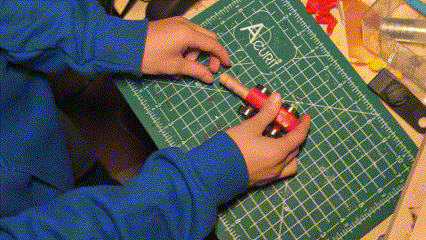

Step 2: Attach Ball Bearings
Next, attach the ball bearings by putting glue on the axle-like rods on the bottom of the slug and sliding the ball bearings on. I used hot glue, which worked well most of the time. However, in one test the ball bearing came off, so you may want to experiment with a stronger glue, or at least use more glue than I did.
