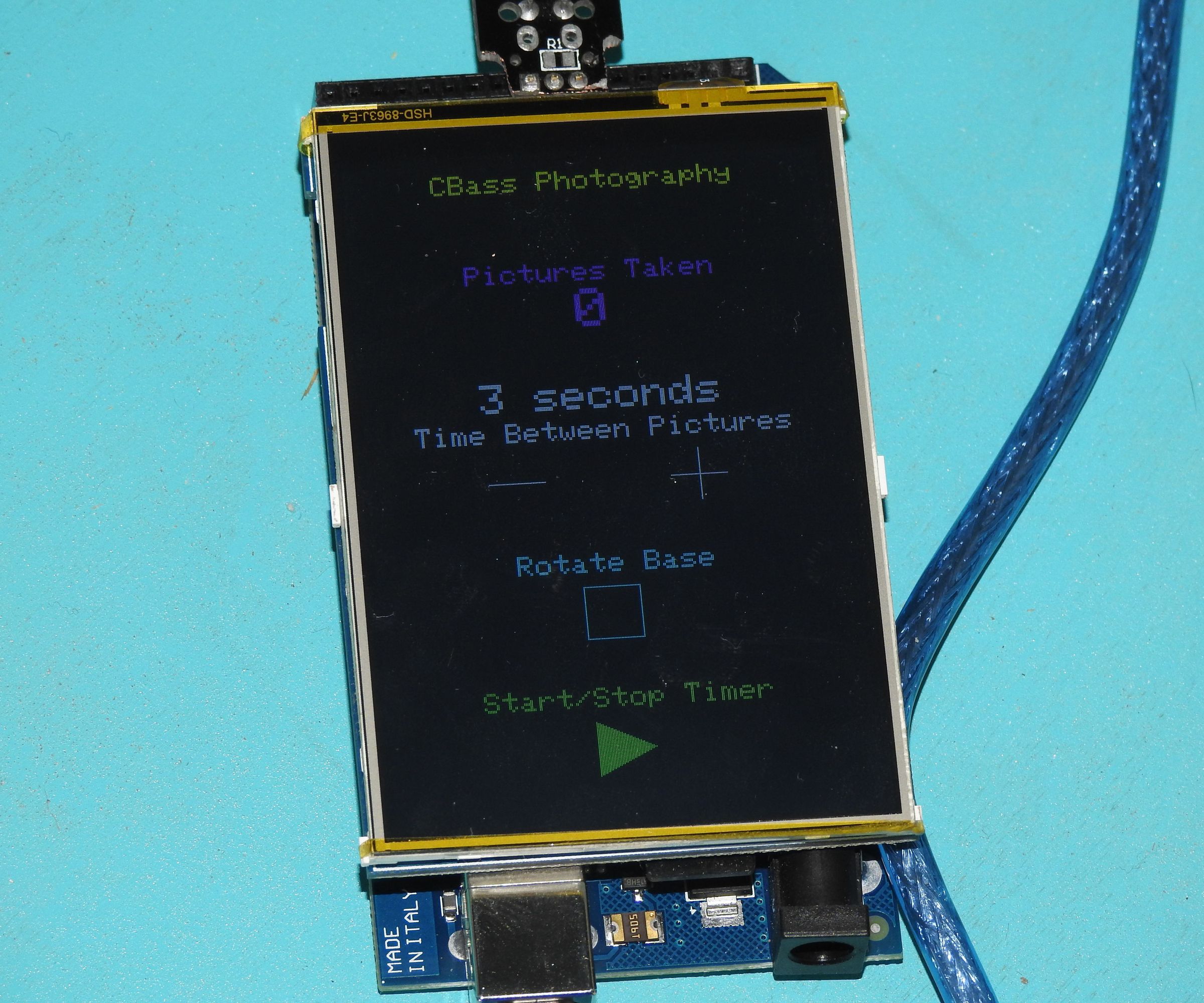

Step 4: Build Your Blynk Project
I use Blynk to build an app and connect to the board. Here is how I have it set up.
  • Pictures Taken label
    • Input is Virtual Pin 5 (V5)
    • Reading Rate is PUSH
  • Bluetooth accessory (near the bottom of list in Blynk)
    • Select your bluetooth device from the list (box must be powered on and connected to phone via bluetooth)
  • Timer label
    • Input is Virtual Pin 6 (V6)
  • Start/Stop button
    • Output is Virtual Pin 1 (V1)
    • Mode is SWITCH
    • Label on is STOP
    • Label off is START
  • Add Time button
    • Output is Virtual Pin 2 (V2)
    • Mode is PUSH
    • Label on and off is +
  • Subtract Time button
    • Input is Virtual Pin 3 (V3)
    • Mode is PUSH
    • Label on and off is -
I skipped V4 because I am planning on adding a motorized mount later to rotate the camera between shots if selected.
*DON'T FORGET TO COPY THE AUTHENTICATION CODE IN THE APP INTO YOUR ARDUINO CODE*
Step 5: Testing the Finished Product
Connect the device to a USB power source (computer, plug in or my favorite, a portable power supply with USB ports which is usually used to charge cell phones).
On your cell phone, pair the bluetooth device (mine was listed as HC-06). The passphrase/pin/code was 1234.
Start the Blynk app and select your project. It should connect to the bluetooth device. Power up your Nikon camera, switch it to remote control mode and press buttons on the Blynk app as you see fit!
