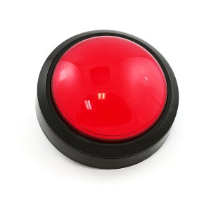

Step 4: The Push Button
The centerpiece of our external board was a large red dome push button from SparkFun. This was a good starting point for the game because it is much more fun to push than the on-board Nexys 3 buttons. Plus, it has the added bonus of containing an internal LED.
The internal LED is designed to be used with a 12V DC power supply so it must be modified to be used with the 3.3V output from the Nexys 3. To do this, untwist the bottom of the button and pull out the LED-switch compartment. You should be able to pull out the plastic holder that contains the LED and a resistor. Simply desolder the included resistor and replace it with an appropriate new resistor. We used a 100 ohm resistor as the replacement.

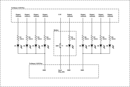

Now we need to wire up the LEDs and button so that they can be connected to the I/O pins of the Nexys 3 board.
First we soldered a resistor to the anode of each of the LEDs. For our red LEDs we found that 100 ohms was an appropriate value. Next you'll want to solder additional insulated wire to the ends of each resistor; around a foot each should be enough. We also used heat shrink to cover the exposed wire and resistors.
A common ground wire needs to be soldered across all of the cathodes of the LEDs. Just cut around 6 inches of bare wire and wrap each cathode around the bare wire, soldering them together as you move across. At the last LED on each side you need to solder additional insulated wire such that it can be connected to the GND pins on the Nexys 3 board.
To connect the button, you need to solder additional insulated wire to both terminals of the LED in the button. Additionally, you will also need to connect wires to the terminals of the switch in the same fashion.
