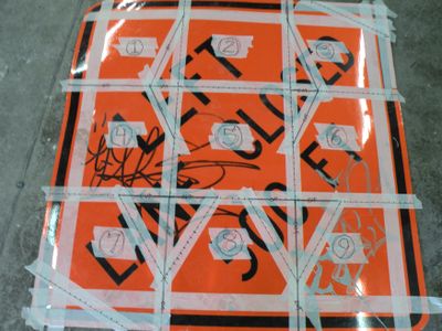

Step 2: Signs!
Now it's time to butcher a real sign. Find them in junkyards, alleys, and through friends. Do not steal signs. The one I have has graffiti on it, which I didn't clean off -- it shows that the chair is one-of-a-kind, and I don't think you should cover up the scars it gained out in the world.
Start by laying out your sixteen inch grid again, this time with masking tape. Mark out the triangular fins. The fins on the underside of the seat in the finished chair are cut from squares seven, eight, and nine. You can see how they are laid out in the pictures: those fins are 12" by 6" and are creased along the hypotenuse.
The fins that secure the back are 12" by 4" (attached to square 2) and 8" by 4"(attached to square 5), creased along the 12" and 8" sides.
The fin that holds the back of the legs together is made from squares three and seven and is 12" by 6", creased along the hypotenuse.
Along all the folds, strike a center line and, measuring from the centerline towards the corners, make a tick every 3/4". Drill out each tick with a 3/8" bit to make the perforations that will allow the sign to bend. This makes 3/8" diameter holes that are 3/8" apart.
Where cuts are necessary, use a jigsaw with a fresh metal blade. Aluminum is very strong, but rather ductile and soft. I dulled the drill bit considerably -- there are an awful lot of holes to drill.
