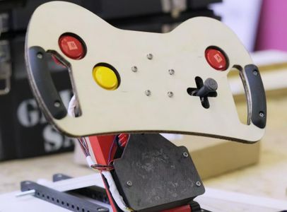

Step 4: Assembling the Wheel
You can start by adding the grips. Align the holes and use the M3 16mm nuts and bolts to secure it.
Step 5: Adding the Button Mounts
You can now place the printed Button mounts over the holes for the button and mark the place you need to drill. it's not necessary to predrill but if you want you can, just make sure you don't go completely through the plywood. Then you can secure it by using small wood screws.
Step 6: Adding Joystick Module 1
Now we assemble the joystick module. Place the joystick module in the joystick and secure it with two M3 5mm nuts and bolts. (Tip: you can already solder some wire to the joystick)
Step 7: Adding Joystick Module 2
You can now place the Joystick assembly over the cross cutout, make sure that the joystick is in the middle of the cross by flipping the wheel. Once certain that the joystick is in the middle, mark the place you need to drill. Make sure you don't go completely through the plywood. Then you can secure it by using small wood screws.
Step 8: Adding Baseplate Shaft Connector
Place the Baseplate shaft connector and align the holes with the holes in the baseplate. Attention !!! : make sure the hole in the Baseplate shaft connector to lock it to the shaft is pointing upwards for easy access.
Step 9: Adding Buttons
Now just slide the buttons in from the front and pop them in place.

Step 20: Adding the Steering Wheel 1
Now take the Steering wheel assembly, place it over the shaft, and press it down firmly. Attention!!! : Make sure you align the steering wheel to the center line of the Potentiometer.
Step 21: Adding the Steering Wheel 2
Drill a hole through the provided hole in the Baseplate shaft connector and secure it by putting a screw through it.

Step 27: Software Upload
For adding the GP2040-CE software to the Raspberry pi Pico please visit this GitHub page by Glenn De Backer:
https://github.com/glenn-de-backer/pico-switch-controller
It has detailed instructions for the software configuration.
Step 28: Software Configuration
To enter configuration mode, you have to hold down the Button S before plugging into a computer. Then Open your browser and navigate to http://192.168.7.1
In the attached document you can find much more detailed description about software configuration.
Step 29: Software Tip!
There is a possibility that after everything when you plug it into a Nintendo and start playing the car starts driving backwards without any inputs. To correct this, you must enable the Analog Stick 2 X Pin and Analog Stick 2 Y Pin and select them to pins that are not wired to anything. By Doing this the Nintendo will not register any false input.
Also, you might have to invert both the X and Y axis of Analog Stick 1.
