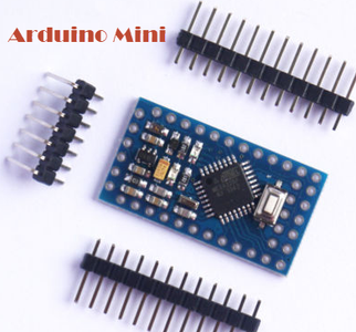

1x - Arduino Mini Pro - $2.42 (You could use nano or uno as well)

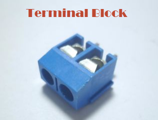

2x - 2 Pin Screw Terminal Block Connector

First step was to put the pieces together. Using the schematic provided I soldered the arduino, connectors, and resistors to the pcb board. Next I soldered the buck converter and the relay.

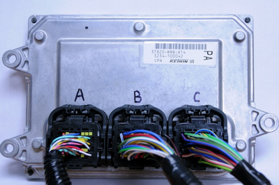

Step 3: Finding the ECU Outputs
Now you need to find a pin out of your ecu. The two wires I needed is the Engine Speed Sensor (to find RPMs) and the throttle position sensor. In my case I have a electronic throttle system. If you have a mechanical wire throttle you could use a physical switch and change the arduino code a bit.
WARNING: If you are not comfortable with this please do not try. Find a professional. I am not responsible for any damage to you ECU or vehicle.
I unplugged the cables from my ECU. Once I found the 2 wires, I spliced into them and ran wire to later connect to the arduino.
