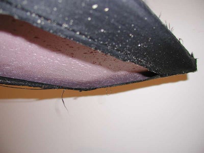

The skirt made of four pieces of fabric sewn together at the edges so the edge that touches the ground is smaller than the edge which fastens to the craft in order to catch air efficiently. The top of the skirt is pined onto the sides of the foam body with regular straight sewing pins. This holds the skirt on well with little air loss, but could be more secure, as pins often come loose and become ineffective. The picture at left was taken after running the craft on a gravel covered parking lot.
This open-bottom skirt design is very simple and effective at holding air while creating little friction, but it does have some issues. When running on surfaces with sand and other loose debris, it tends to scoop up said debris and weigh down the rear end of the craft. Running on rough surfaces also tends to wear and fray the skirt. A tube like design with holes on the inner wall would help to solve this problem and would still be easy to attach to the foam, but I haven't tried this design yet.
