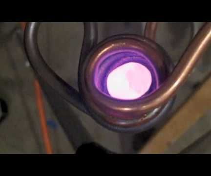

You can read about how to make a 3 or 12kw induction heater here.
You can see one of many video of my induction heaters on Youtube. This is the 3kw unit here.
