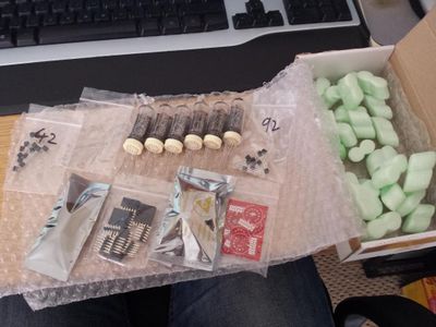

PV Electronics Components and Materials
It is noteworthy that I sourced the 'heart' of my Nixie Project components from PV Electronics. You're not required to do so yourself, but it may make your build easier if you are following this guide to the letter. I must say that the guys at PV Electronics are top-notch for Sales Service. I spent about 3 hours on-and-off chatting to one of their Support Operators (named Pete) via their browser-based Messaging Service (I have the transcript to prove it!), and we went through all the potential components I needed with clear and concise answers to all my questions no matter how technical or dumb.
- IN-14 Nixie Tube x6
- IN-14 Cell PCB x6
(NOTE: The picture on the site is of the 'old' v1 Cell, whereas the one you'll receive is v2 which doesn't accommodate holes for the decimal/comma cathode legs.) - 6x2 pin Female Header x6
- Neon Lamp x5
- HV Module x1
(NOTE: At time of writing, the web shop does not list this item. You will have to request the item via Live Chat from one of their Support Operators.) - K155ID1 Nixie Driver IC x1
