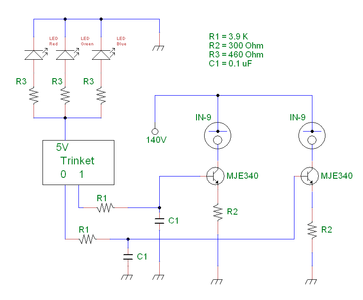

Step 2: Circuit
The circuit is pretty straight forward. The height of the plasma in the nixie tube is a function of how much current passes through the tube. We have a fixed 140V from the power supply and we use a transistor to control the current flow. The current flowing through the nixie tube is controlled by controlling the current into the transistor base.
The trinket has 3 outputs that can supply pulse width modulation (PWM) but here we will only use two of the three, outputs 0 and 1 on the trinket. By adding a resister and a capacitor we can filter the fast pulses into a (nearly) DC output. This can be then used to control the height for the nixie bargraph.
To light up the inside of the pumpkin I decided it probably wasn't a good idea to use a burning candle so I wired up a 10mm RGB led to the 5v output from the trinket with some current limiting resistors. This lit up the pumpkin nicely.
