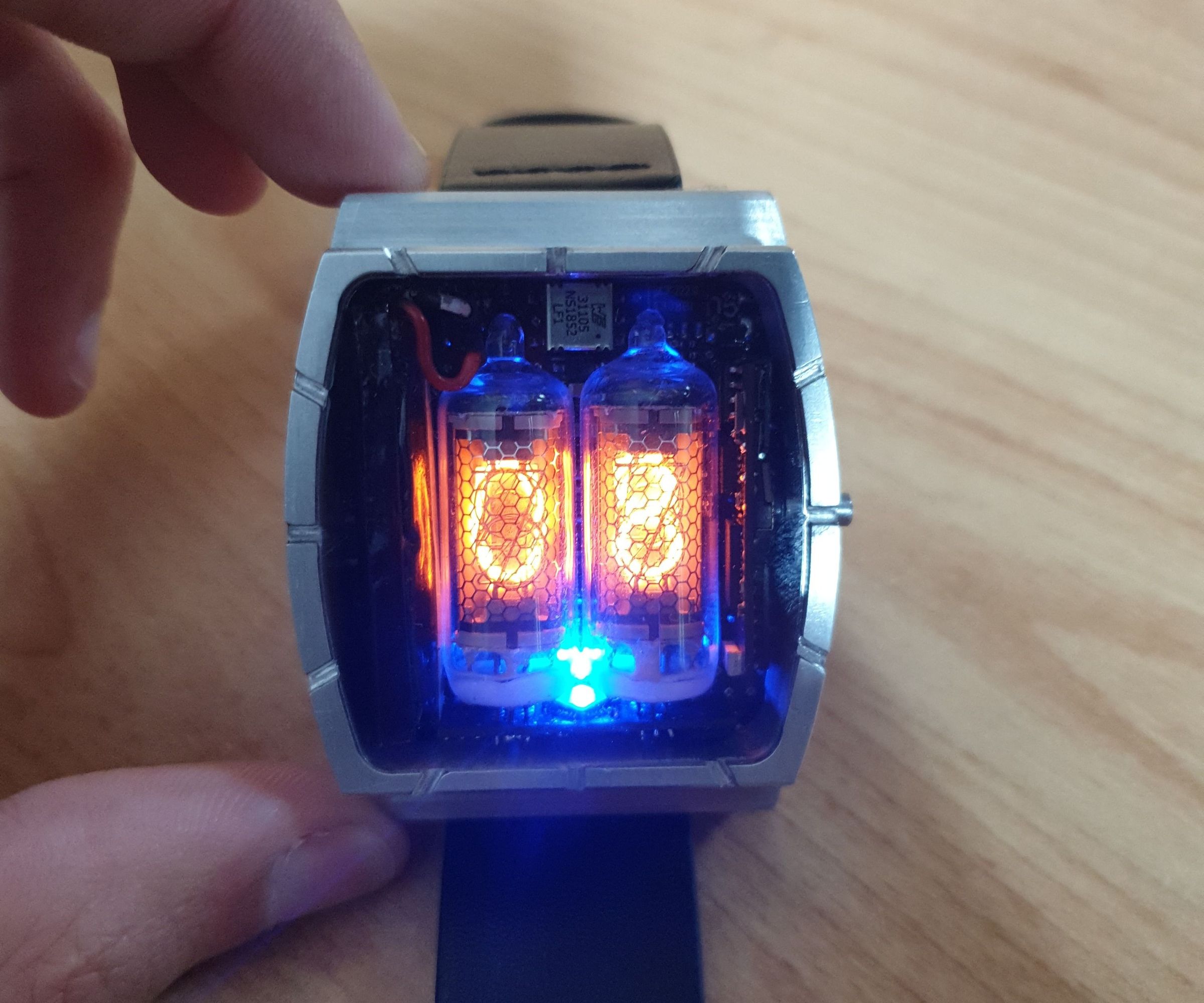

When the electronic design was ready and all the sub circuits where tested I started designing the PCB (Printed Circuit Board). I was making mock-ups with paper and the parts (picture 1). Measuring the width, height and length of every component was a painstaking process. After weeks of designing and laying out the PCB they got ordered and shipped to me. (picture 2).
During every step of the way I had created test-programs for every part of the watch. This way the final software could easily be copied together.
The soldering of every component could begin and took me about a day.
Testing and putting the whole watch together (Picture 3,4,5,6,7) It worked.
I 3D printed a case for the watch and eventually found the watch to be too big. So i decided to create a new one and made the four tube watch a prototype.

After months of designing the new watch it could also be assembled. I used some tools available on my school to solder the Tiny pitched IC's (Picture 4). This took me several days because I ran into some problems but eventually I got the electronics working (Picture 5).

I designed the case in parallel with designing the electronics. Each time checking in a 3D computer software if every component would fit. Before CNC (Computer Numerical Control) milling the case, a 3D printed prototype was made to make sure everything would fit. (Picture 1,2)
After the case design was done and the electronics worked I started research about how CNC machines must be programmed (Picture 3). A friend of mine who has knowledge about CNC milling helped me program the CNC machine. So the milling could begin. (Picture 4)
After the milling was complete i finished the case by drilling holes and polishing the case. Everything fitted the first time right. (Picture 5,6,7)
I had designed a latch for an acrylic window. But the latch was milled away by accident. Using a laser cutter I cut a window from acrylic this was glued to the top of the watch (Picture 9).
