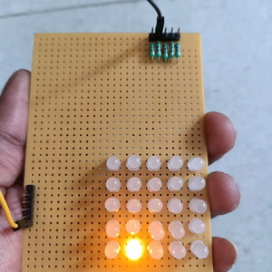

Step 1: Setting Up Your LED Matrix
  1. Line up Cathode and Anode Wires: Connect your LED matrix to the breadboard with the cathode (negative) and anode (positive) wires aligned neatly.
  2. Connect Cathodes to 330-Ohm Resistors: Take the cathode wires of the LED matrix and connect each one to a 330-ohm on the breadboard resistor. Ensure that each cathode is securely connected to its respective resistor.
  3. Connect Resistors to the Output of a NOT Gate: Now, connect the other end of each 330-ohm resistor to the output terminals of a NOT gate.
  4. Connecting the Anodes: If your images are going to be symmetrical, connect each Anode wire to its opposite Anode wire to save a lot of hassle later.

1. Assign Outputs for Each Symbol:
  • Utilize one output from each decade counter to represent a row of LEDs corresponding to a symbol (rock, paper, or scissors). Avoid using pin one of the decade counter outputs as it is vital that it is not used
2. Connect Cathodes and Anodes:
  • For each symbol, connect the cathodes of the LED matrix to the outputs of the corresponding decade counter.
  • Connect the anodes of the LED matrix to the same output as the corresponding cathode through diodes.
3. Diode Configuration for Anodes:
  • If you connected the opposite anode wires earlier, you'll only need half the number of diodes for each anode. Adjust the diode configuration accordingly to match the wiring setup of your LED matrix.
4. Experiment with LED Matrix Designs:
  • Use online LED matrix simulators to experiment with different designs and configurations before implementing them on your actual LED matrix. This step allows yo
5. Enable/Disable Decade Counters:
  • To isolate and test individual symbols, connect the reset pin of the respective decade counter to power. This action effectively disables the counter, allowing you to focus on testing specific symbols without interference from others.
