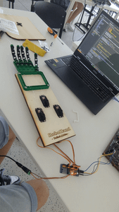

Step 8: Building the Robotic Hand to Show the AI’s Move
To make the AI more expressive, and fun, I added a robotic hand that performs the AI’s move in real time.
Instead of keeping everything on screen, I wanted the AI to physically throw rock, paper, or scissors, just like a real opponent.
1. Repurposed Toy Hand
I didn’t design the hand from scratch, instead, I used a kids' robotic hand toy and modified it to be servo-controlled.
  1. I mounted it to a wooden baseplate
  2. I engraved the base with:
RoboHand — Rafael Aldaz
2. Servo Setup
I used three MG996R servo motors to control finger groups:
  1. Servo 1: Controls the thumb
  2. Servo 2: Controls the index and middle fingers
  3. Servo 3: Controls the ring and pinky fingers
Each servo pulls a set of strings attached to its finger group.
3. Hand Gestures Mapping
When the AI selects its move (via the YOLOv8 model), a message is sent to the servos to form:
  1. 🪨 Rock: All fingers closed
  2. Paper: All fingers open
  3. ✌️ Scissors: Index + middle fingers open, others closed
4. Electronics & Integration
  1. The servos are controlled by a PCA9685 driver for reliable PWM output
  2. The Raspberry Pi sends commands to the servo controller whenever the AI makes a move
  3. The movement is perfectly synced with the web game interface via WebSockets
Summary
This final step brought the AI’s decisions into the physical world, turning it from a virtual opponent into a robotic player sitting across from you.
Whether it wins or loses, the hand makes it feel personal and real.
✅ Repurposed toy hand
✅ Controlled by 3 servos
✅ Reacts instantly to AI predictions
✅ Totally integrated with the AI game console
