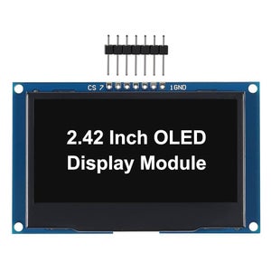

OLED Display (SSD1309, SPI) 1

Secure the Oled screen with double sided tape and connect it to the pi.
