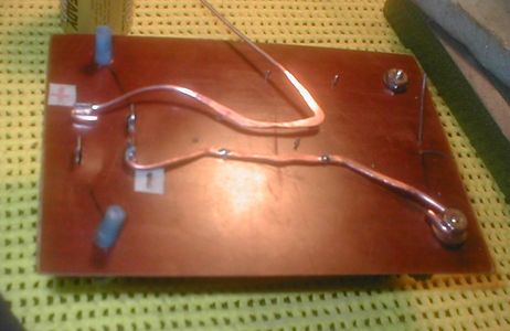

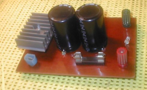

I first used this technique in a project I have posted to this site previously, but I did not elaborate on it then. This whole article is about the method I am doing. The introductory picture shows the top of the board I will be using this method with. What interests us is what is going on underneath though. We'll get to that shortly.

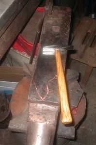

Step 2: Marking Wire
Here I have used a felt tip marker to mark where I want to work on the wire. Look carefully for blue marker marks on the wire.

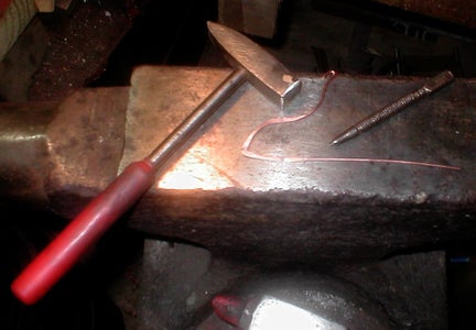

Step 3: Flattening Wire
Here we can see how I am flattening out the wire. I am using an anvil, and a small hammer with a flat face on it. Note that I am not using a large hammer, this is delicate work.

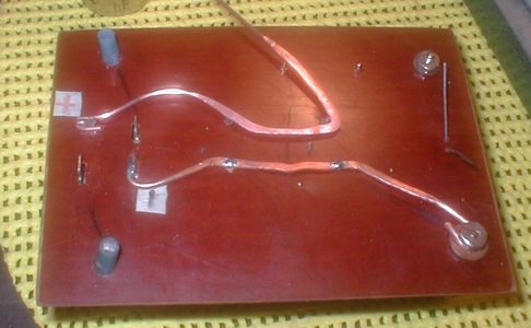

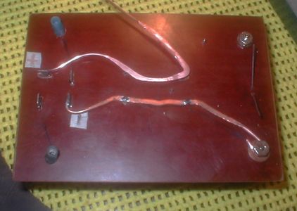

Step 5: Aligning Conductor
Here we see the conductor aligned over the leads the conductor needs to attach to. I'm not calling it a piece of wire anymore because it really isn't.

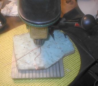

Step 8: Drilling Conductor
Here I am drilling holes in my conductor so I can put my component leads through it.

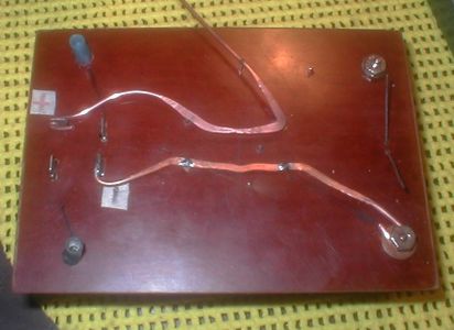

Step 9: Fitting the Conductor to the Project
Now I have to put the conductor on the board, on the leads it needs to attach to, in order to solder it. I took this photograph when I test fit the conductor. It fits.

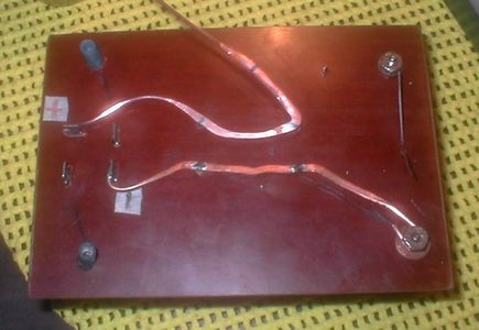

Step 10: Solder Conductor
All that remains to do now is simply to solder the leads to the conductor. I also trimmed the excess on the end before doing this too.
