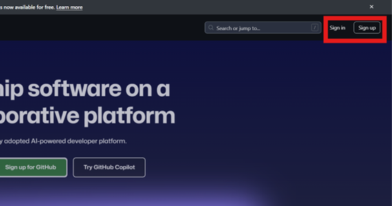

Step 2: Click on the Sign Up Button
Click on the button on the top right of the page to begin setting up your GitHub account.

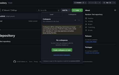

Step 7: Opening Codespaces
Click on the GREEN button titled “Code” visible on your repository page.
A new menu should appear below it with another GREEN button to click on.
Once you have clicked on the second button a new tab for Codespaces should be opened.

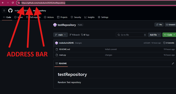

Step 10: Sharing Your Project With Others
Copy the link from the address bar and feel free to share your project with as many people as you want!
