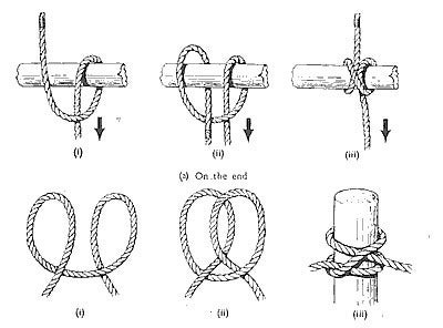

For the lashing knot I used the simple clove hitch to lock the handle forks together around the stone. This is a very simple fiction knot and will not over stress these wood fiber materials and give us the best chance of success.
