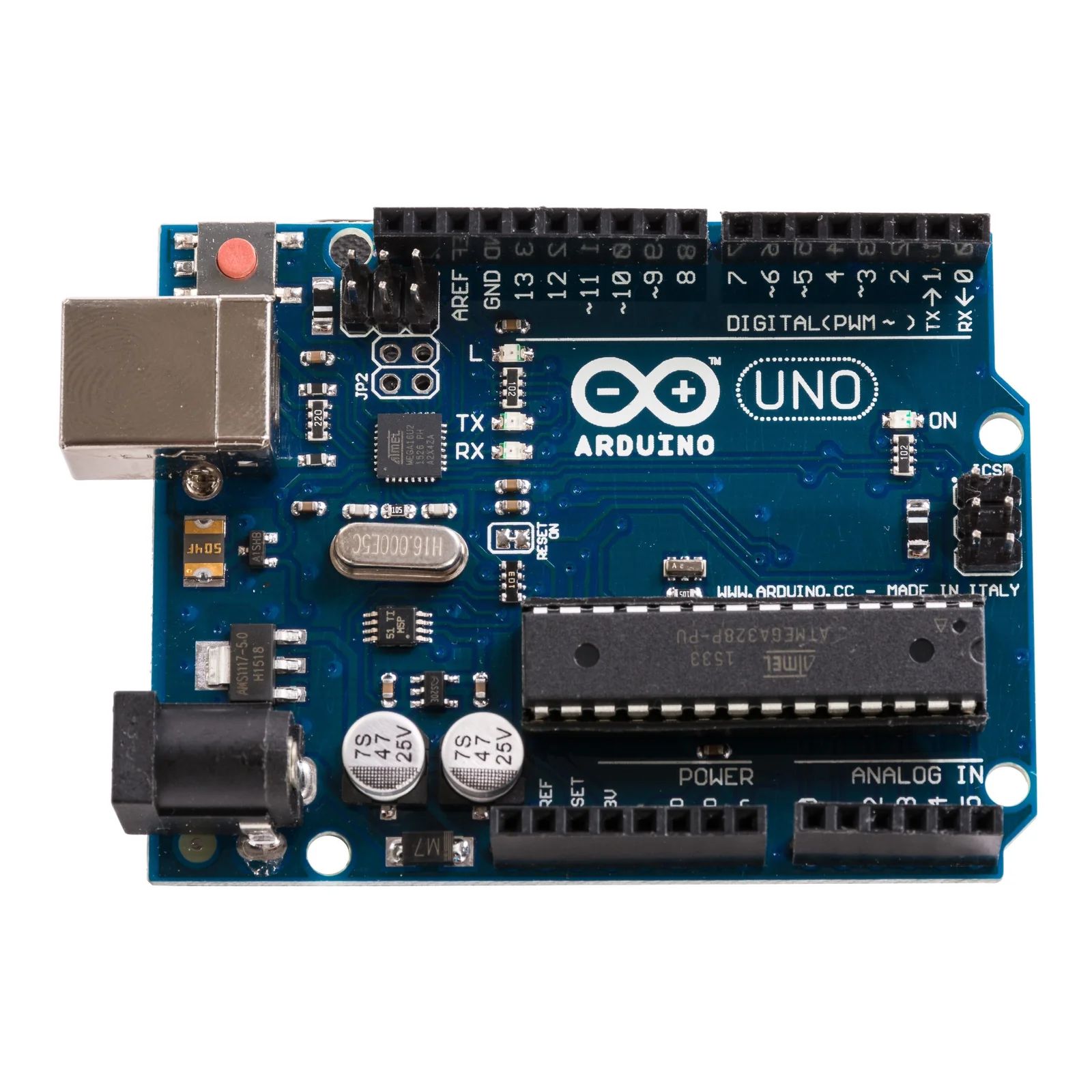

  • Arduino Uno R3 Board

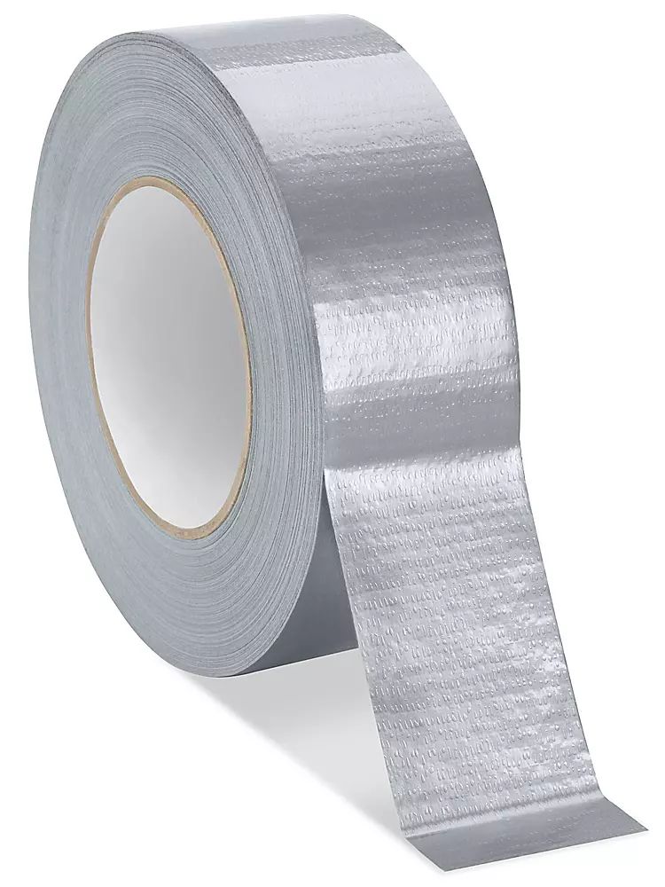

  • Duct Tape

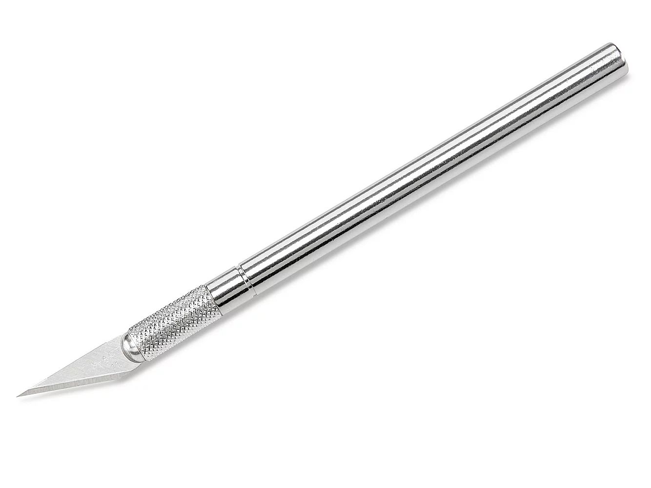

  • X-acto knife

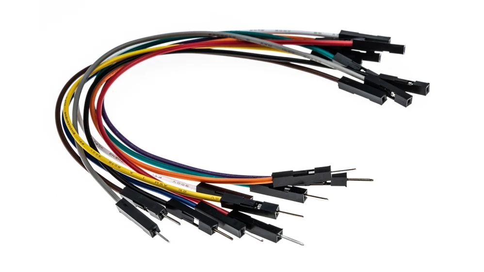

  • Female-to-Male Dupont Wires

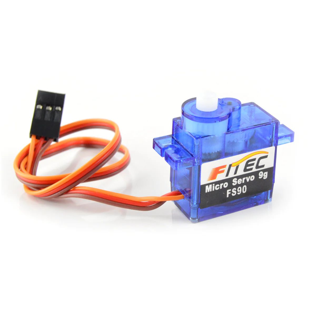

  • Servo Motor
  • Breadboard Jumper Wires

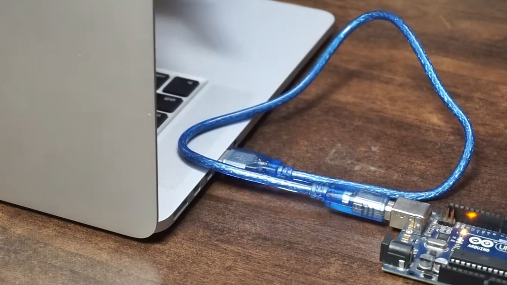

  1. First, install the Arduino app on your computer and then use the blue thick wire to connect your Arduino board to your computer and upload the code on Chat GPT stating"Write me a code for Arduino IDE using a SOR4 ultrasonic detector and a UNO microcontroller with an SG90 servo motor. Have it rotate 90 degrees when an object is detected less than 5 inches when the object disappears the servo should rotate back to 0"

  1. SG90 Servo Motor:
  • VCC (Red Wire): Connect to Arduino 5V pin.
  • GND (Brown/Black Wire): Connect to Arduino GND pin.
  • Control (Yellow/Orange Wire): Connect to Arduino digital pin 9
