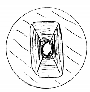

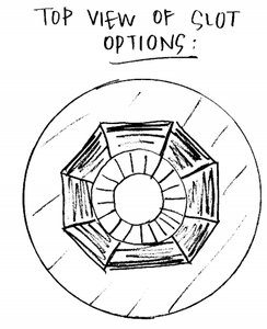

Step 1: Sketches and Decision Making Process
I tinkered with various ideas for the material that would be appropriate for the design, being that it would mainly be used for toiletry items like lotions, shampoo, conditioners, or even different types of sauces and condiments. I created a couple of prototypes with items I had around my house for measuring and scaling purposes, primarily for the interior funnel. First is my initial sketch, where the interior forms are represented using dashed lines. I used the chip can lids to cut or draw shapes onto, so I could test the versatility of different lotion bottle lids. I used a chip can lid to cut out a slot, so I could insert a silicon funnel (because it is flexible and collapsible) into the slot making a flat surface that was easier to measure.
