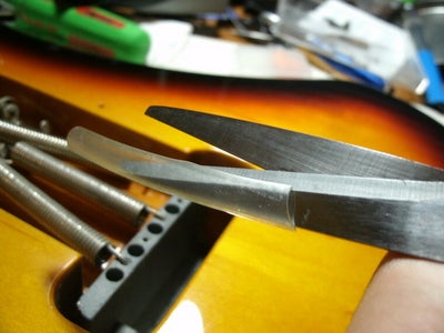

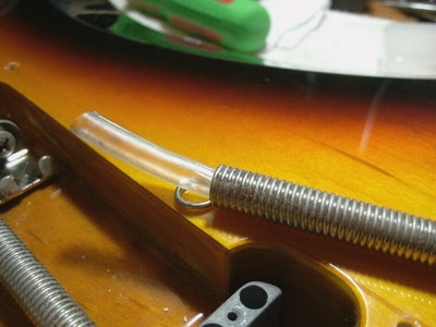

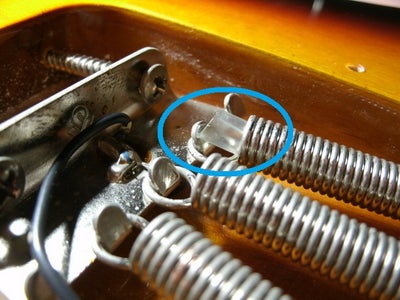

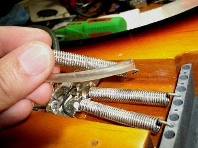

Just take a small, flexible piece of hose (the ones employed to blow air into aquariums) and cut it to size so you can insert it inside the spring.
That's it.
This works for every guitar with rear-mounted springs, be it a Synchronized or Floyd Rose tremolo. And it makes a HUGE difference, especially when recording.
