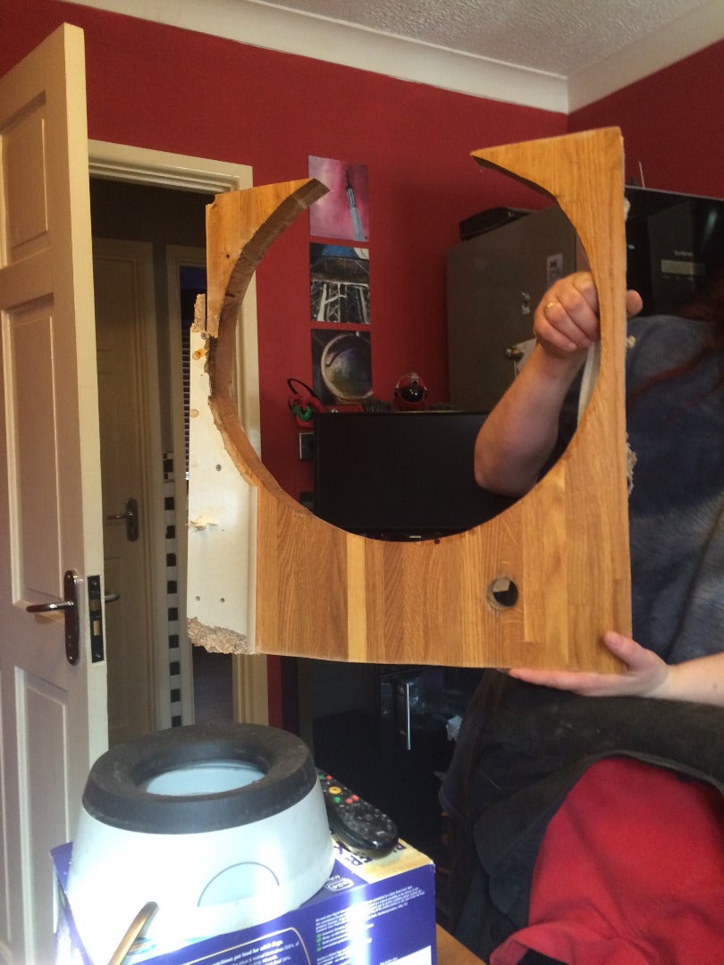

A couple of weeks ago however I received a text message from a very good
friend of mine who was fitting a new kitchen sink into his worktop. It was solid oak and "was as hard as steel" and was asked if I wanted it otherwise it would be taken to the dump. This is the picture I received with the message.
When I received the top I had a bit of chipboard and screws to remove and then cut some excess bits off. You can see where I had started drawing on the wood to make sure my template for the hull fitted the worktop.
