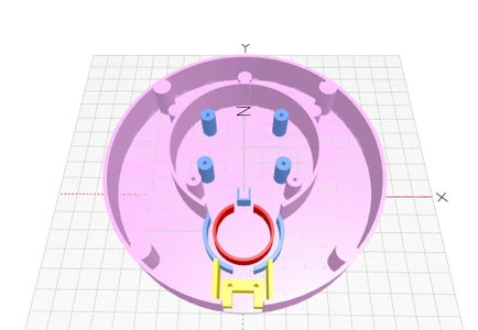

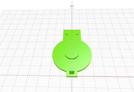

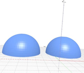

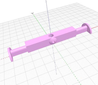

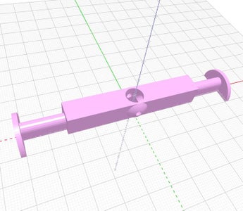

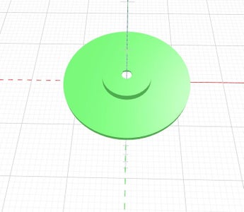

Step 1: CAD Design
The 3D printed elements were designed using BlocksCAD, sliced using Cura 4.5.0 and printed on a Elegoo Neptune 4 Pro.

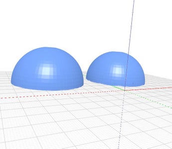

Head 30(L) x 30(H) x 30(W) mm, weight 5g (2 parts)
Body 60(L) x 60(H) x 60(W) mm, weight 16g (2 parts)
Pivot 104(L) x 20(W) x 10(H) mm, weight 8g
The head, body and pivot come in two versions to suit 6 & 7.5 mm tubes.

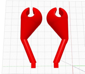

Legs 89(L) x 15.8(H) x 32(W) mm, weight 23g (2 parts)
Feet 97.6(W) x 76.9(L) x 10(H) mm, weight 8g
Coil Former 26(dia) x 2.5(H) mm, weight 1g (2 parts)

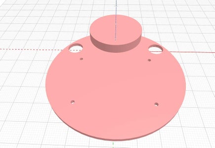

The base consists of three elements the main support and two covers to hide the electronics.
Base1 120(dia) x 22(H) mm, weight 89g (The main supporting base).
Base2 39.6(W) x 58(L) x 9 (H) mm, weight 4g (Cover for coil and sensor).
Base3 75(W) x 87.5(L) x 8(H) mm, weight 17g (Cover for electronics board).

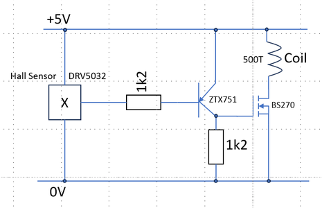

Motion is created by the interaction of the magnet attached to the straw and a pulsed magnetic field generated in the coil when the magnet passes the Hall sensor.
The Hall sensor (will detect a magnetic field of either polarity), in the presence of a magnetic field it will have a low output and a high output in the absence of a magnetic field.
The output is connected to the base of a PNP transistor which is switched off when the sensor output is high and switched on when the sensor output is low.
The PNP transistor is used as an inverter between the sensor and the NFET.
As its required to energise the coil when the sensor detects a suitable magnetic field the gate of the NFET requires a positive voltage. However, in the presence of a magnetic field the sensor output is low. Thus the requirement for the inverter.
The coil is mounted close to the sensor such that when the magnet passes the sensor the coil is switched on.
Assuming the magnet is orientated to be attracted to the coil.
This immediately attracts the magnet towards the coil but in doing so it moves away from the sensor. The deminishing magnetic field to the sensor results in the coil being switched off. The magnet then swings back towards the sensor re-energising the coil and repeating the process.

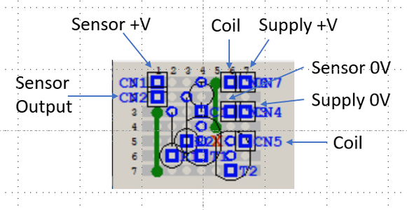

The circuit is assembled on stripboard measuring 7 holes x 7 holes and with only one track cut at hole co-ordinates (5, 5).
Make the track cut with a 3mm drill bit.
Assemble the circuit such that the components are mounted horizontally to the board and as low profile as possible.
Fit shorting links followed by the resistors, right angle connectors, capacitors then the transistors.
This assembly flow fits components of increasing vertical height with the lowest profile first which makes soldering easier.
Connections are made to the stripboard via straight pin headers with the leads soldered to the pins.
Check if any shorts or opens exist were they should not with an DMM prior to the application of power.
Remedy any faults found before applying power.
Solder the free end of the leads from the USB board to the appropriate pins (+V & 0V), on the circuit board and check there are no issues when power is applied. Correct any issues before proceeding.
Solder the connections for the sensor (+V, output & 0V) and the coil (+V and FET drain), to the pins on the circuit board, taking care to ensure that the sensor connections are correctly orientated. The coil is not polarised and therefore can be connected either way round. However, you will need to ensure that the magnet is attracted to the coil.

Step 9: Body
The body consists of two hemispheres each with a cross brace and central holes to aid the joining process by keeping the hemispheres aligned.
Apply adhesive to the cross braces but not around the central hole.
To aid alignment the straw can be inserted through both halves whilst the adhesive cures, hence the requirement to not apply adhesive to the central hole. allowing the straw to be removed.
Step 10: Pivot
The pivot is constructed in one piece with a central hole to accommodate the straw.
Where the pivot and hip contact both these surfaces are curved.
Therefore, ensure the curved surfaces of the pivot arms are pointing downwards.

Step 13: Legs and Feet
The legs consist of two parts which are attached to the feet.
The feet are printed as one piece with an integral spacer bar.
Attach the feet (with the single heel toe facing the USB socket), to the base with 2 x M2 x 8mm self tapping screws.
The legs are inserted into slots in the feet with the flat surface of the leg facing inwards and the point (ankle), of the leg facing towards the USB socket.
The legs are a press fit but can be glued if required.

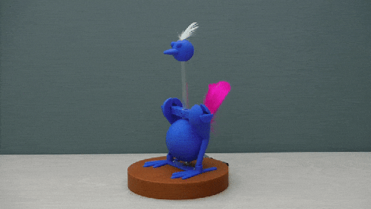

Step 17: Operation
If the bird is optimally set up it will auto start with the application of power.
