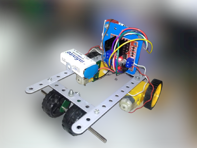

After this you will need to give Power to the circuit using the battery. So for that, connect Positive terminal to 12 V input in the L298N motor driver and Negative terminal to GND of Motor Driver.
Now connect the Motors to the Motor Input of the Motor Driver as shown in the diagram.
Put all these on a base made of metal because some cardboard are not that strong. So, I recommend to make a metal base from Old toys or any other thing.

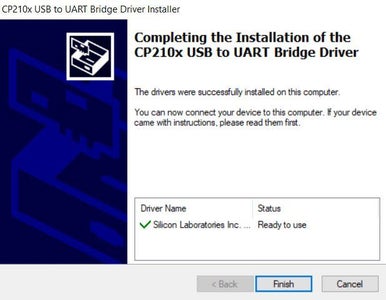

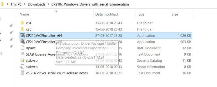

  • It might still not work in few cases. So for that you will need to install 'CP210x USB to UART Bridge Virtual COM Port (VCP) driver'. You can Click Here to Download it.
  • After Downloading Extract the ZIP file and click on 'installer x 64bit'. Click 'Next' and then click 'Agree' and then 'Next'. After that it will take about 5-10 seconds and then click on 'Finish'
  • Now try out changing the ports from the app and it will work.
