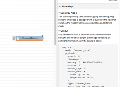

Step 4: Go Ahead and Drag a Wireless Gateway Node Over to Your Flow Canvas to Get Started.
ncd-red-wireless Provides the nodes that manage the serial connection, parse incoming sensor data, filter it by specific parameters, and allow you to configure the wireless sensors.
Step 5: Finding Your Wireless Sensors
When you’ve delivered the node you’ll be able to view the info tab, which contains records about the node’s capability, this tab is well-populated for maximum node-red packages and consists of treasured statistics, often you will now not want to view any other documentation outdoor of the info tab, so hold it in thoughts even as you're building your flows when you have a question approximately how a node works. The next element we want to do is configure the node, when you first add it you’ll note that there is a small triangle at the top right corner next to a blue dot, the triangle indicates that the node wishes extra configuration, the blue dot indicates that the node has no longer but been deployed as part of the flow.
- Double click on the node to open up the configuration options.

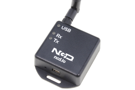

- Click on the pencil icon next to the Serial Device field to configure your USB router, this will open a second configuration panel that only has a few options.
Step 6: Click on the Magnifying Glass Next to the Serial Port Field and Select the Port That Corresponds With Your Router, Then Click the “Add” Button on Top.
Step 7: Serial Device Field Will Now Be Populated Based on That Selection, and You Can Click “Done”, You Now Have Direct Access to Your Wireless Sensors! to View the Data Coming In.
Step 8: Now Go Back to Your Palette and Type “debug” Into the Search Field at the Top, Grab One of These Nodes and Drag It to the Right of Your Wireless Gateway
Step 9: Double Click on It and Change “msg.” to “complete Msg Object” Click Done
Step 10: Now Draw a Line Between the Two Nodes, and Click “Deploy” on the Top Right of the Window..
Step 11: Working With the Data
Now out of your wireless sensors data is gathered and it is output to the “debug” tab, this "debug tab" is placed within the right sidebar subsequent to the information tab. To see the information is available to hit the reset button. In node-red records is surpassed among nodes in a json packet. When the msg object comes into the debug tab you may make bigger it to view the overall list of information that comes with it. This is extraordinarily useful in case you need to quickly see which sensors are checking in. The other issue this node gives is an easy way to interchange your router to the network identity that devices in configuration mode document on, simply hit the button on the left of the node and the tool will switch to the configuration network, hit it once more to return it to listening mode. Once we get the wi-fi tool nodes set up, they may be set to routinely configure a sensor whilst it enters configuration mode, so it’s always available to maintain such gateway nodes present at the flow for speedy configuring a device.
