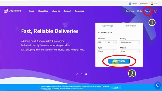

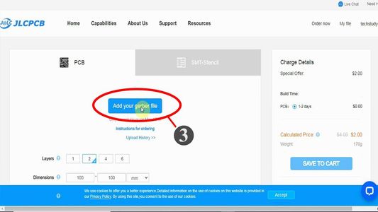

Step 6: Order the PCB
After downloading the Garber file you can easily order the PCB
1. Visit https://jlcpcb.com/RHS and Sign in / Sign up
2. Click on the QUOTE NOW button.
3 Click on the "Add your Gerber file" button. Then browse and select the Gerber file you have downloaded.

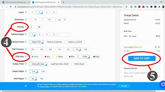

Step 7: Uploading the Gerber File and Set the Parameters
4. Set the required parameter like Quantity, PCB masking color, etc
5. After selecting all the Parameters for PCB click on SAVE TO CART button.

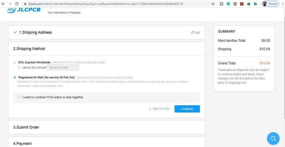

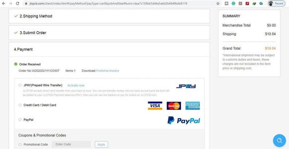

Step 8: Select Shipping Address and Payment Mode
6. Type the Shipping Address.
7. Select the Shipping Method suitable for you.
8. Submit the order and proceed with the payment. You can also track your order from the JLCPCB.com.
My PCBs took 2 days to get manufactured and arrived within a week using the DHL delivery option.
PCBs were well packed and the quality was really good at this affordable price.

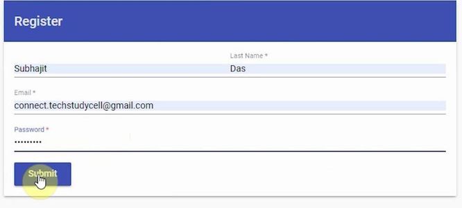

Step 10: Create an Account in Sinric
First, visit https://sinric.com/login
You have to create an account in Snric.
Then log in to Sinric Account.
You will get an API key which will be required in the code.

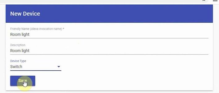

Step 11: Add Devices in Sinric
Click on Add to add devices.
Then enter a name for the device. Alexa will identify the device with that name.
Select the type as Switch.
Click on Save.
In this way add 4 devices in Sinric. Each device will get a unique device ID.

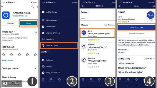

Step 13: Download and Install the Amazon Alexa App.
Download and install the Amazon Alexa App from the Google play store or App Store.
Step 14: Configure the Alexa App for This Smart Home System
Go to "More", then select "Skills & Games"
Search for Sinric and tap on "Sinric".
Tap on "ENABLE TO USE"

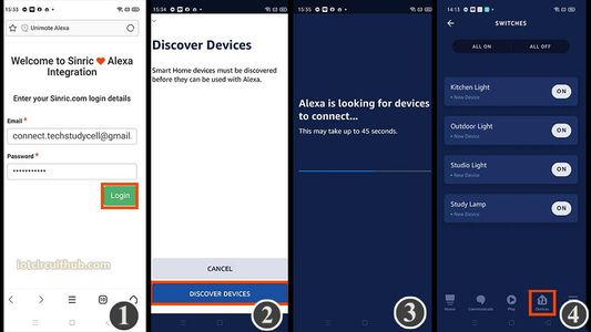

Step 15: Connecting Devices With Alexa
Log in with the Sinric account credentials.
Goto Alexa and tap on "DISCOVER DEVICES".
It will take a minute to add devices. During this time the NodeMCU should be connected with the WiFi.
Tap on "Devices", and tap on "Switch" to see all the devices.
