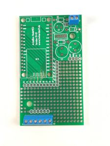

Step 2: Prepare the Terminal Blocks
Find the terminal blocks, they're grey or blue and come in 2-pin and 3-pin shapes. We'll need to slide two 3-pin blocks together.
Step 3: Place and Solder Terminal Blocks
We've to put the blocks into the proto plate. Make sure you place them so that the openends are facing out as shown
Step 4: Place and Solder the Diode
bend the pins of the diode D2. Place the diode onto the pcb and solder the pins.
Step 5: Prepare the Female Headers
Depending from the situation on the market we sell the kits with longer female header. You have to cut these headers to 15 pins
Step 6: Prepare the NodeMCU
Plug both female headers onto the male headers of the NodeMCU module
Step 7: Place and Solder the NodeMCU
Step 8: Remove the NodeMCU Module
Step 9: Solder the Jumper J1
beside the blue terminal block is a soldering jumper. You have to solder a bridge on this jumper if you want to connect later a external 5V power supply
