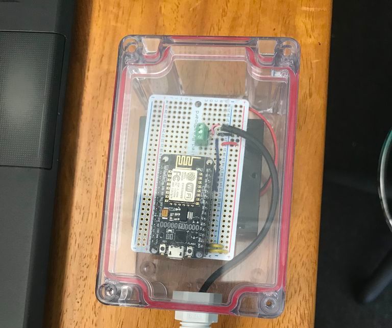

Step 4: The Finished Product
Here is the final board. As you can see we've used a Hall effect sensor attached to a breakout board - which includes the LED and resistors. You simply need to raise the magnet up to the sensor and you will see the LED light up. It will then transmit the state to readiness.io.
