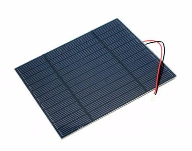

Step 5: Supply Power
In thislast step, you have a NodeMCU able to send your measures to a website.
Now you want this device can be autonomous.
With the Lipo Rider Pro card, you can supply your device with a battery and a supply source like a solar panel.
As you can see on the card’s picture, you have 3 ports.
The USB right port must be connected to your NodeMCU.
Put on the switch above to supply.
On the left, you can see 2 connections;
The one at the top is destined for the battery
The one at the bottom is destined for a solar panel or any power supply between 5 and 12V like
an induction charging PCB..
