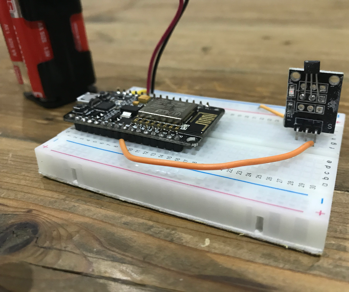

Step 2: Wiring It Up
Here is the basic wiring diagram for the device. You can see what the final version looks like at the end of this instructable.
Whilst not needed we've included the push button in order to publish a manual reading.

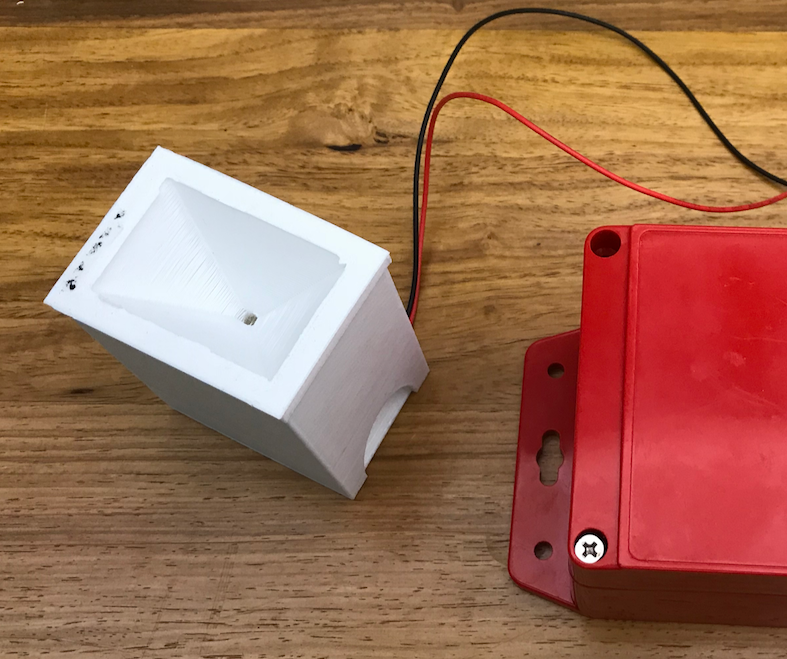

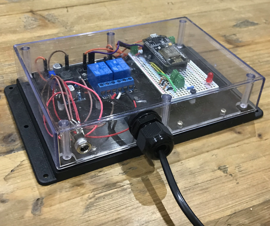

Step 4: The Finished Product
Here is what the finished product looks like. We've actually included the sensor on an external breakout board, so that we can keep the enclosure fully sealed and just leave the sensor exposed.
(We'll post some more photos of the unit - on site once its been deployed.)
