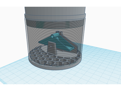

Step 10: 3D Tipping Bucket Rain Gauge and Calibration
Tipping bucket rain gauge 3D link >> https://www.thingiverse.com/thing:4519605
Mine 3d funnel diameter - 95mm 9.5cm ( radius 4.75cm)
Funnel area S= pi *r2 = (3.14 * (4.75 *4.75)) = 70.88cm2
Mine syringe for calibration is 24mm. 24 ml give me 9 tips.
24mm / 70.88cm2 = 0.338cm 3.38mm 3.38mm / 9 tips = 0.375mm
So one tip is 0.375 mm ( 0.0147 inches)
