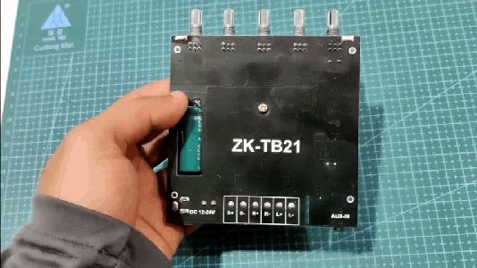

Step 1: The ZK-TB21 Audio Module
For the Audio AMP Module, I'm using the ZK-TB21, which is a 2.1-channel audio power amplifier based around the TPA3116D2 power AMP chip.
TPA3116D2 is a Class D stereo amplifier that can drive speakers up to 100 watts. To drive two 100-watt speakers, the ZK-TB21 utilizes two of these TPA3116D2 chips. one for the left and right speakers, and one for the subwoofer
Because it's a power amp, things get super hot, so there's a heatsink on the TPA chips for the dissipation of heat.
Also, there's a Bluetooth audio IC on this board, which lets us connect with this board for audio streaming.

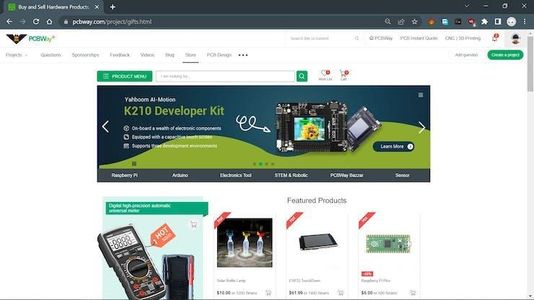

Step 2: PCBWAY Giftshop
As for sourcing the audio module, I used PCBWAY's Giftshop.
https://pcbway.com/s/K2862f
PCBWAY also has a dedicated component store in addition to PCB services.
PCBWAY GIFTSHOP is an online marketplace from which we can source all the major electronics stuff, like Arduino boards, Raspberry Pi boards, Modules, sensors, etc.
PCBWAY has this system that lets us purchase anything from their gift shop with beans. Beans are like redeemable currency or coupons that we get by placing an order on PCBWAY or by sharing your projects in the community to get beans.
Check PCBWAY out for getting great PCB service from here- https://www.pcbway.com/

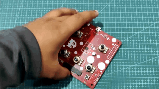

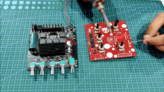

Step 3: MIDI SYNTH Board
Here, I'm using the Midi Synth Board from an audio project I completed a while ago.
https://www.instructables.com/SYNTHESIZER-Made-From-Scratch/
In essence, it was an Atmega328PU-based sound modulation circuit. Five potentiometers are used by Minimal Setup to control tones that are generated using the Mozzie library.
It has an onboard power source that powers the speaker and a small Atemga328 setup using a lithium-ion battery.
Step 4: Modifications in the Synth Board
This project will use a 12V SMPS adaptor to supply power to the audio module; therefore, a buck converter will need to be added to step down the 12V from the adaptor to 5V in order for the synth board to function. The Synth Board contains an IP5303 IC that was added to provide power through a lithium-ion cell.
In addition, the IP5303 cannot operate at voltages higher than 12, and in this project, lithium cells are not being used.
To enable this board to be connected to an external 5V supply, we remove the onboard IP5303 IC and all of its necessary components.

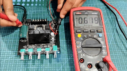

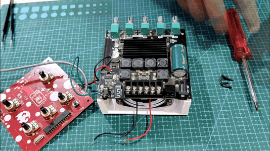

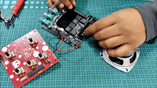

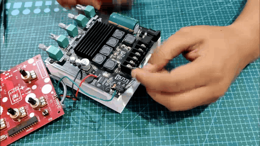

Step 5: Modifications in Audio AMPLIFIER MODULE
The Audio AMP Module requires 12V to power the system; however, the Synth Board requires 5V.
Here is what we discovered about the Audio AMP Module: a small buck converter was added to the PCB because the Bluetooth IC of the audio AMP needs 5V to function.
We used a multimeter to determine the positive and negative terminals, and we added wires to the pads that will subsequently be linked to the VCC and GND on the Synth Board in order to power the board.

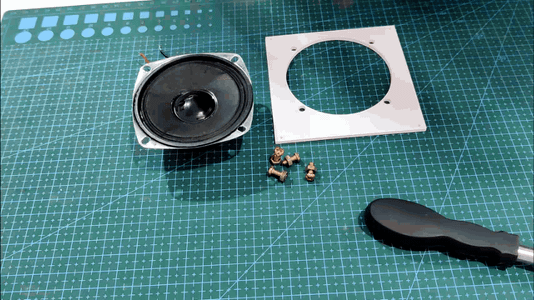

Step 6: SPEAKER
The amplifier we are using can support more high-power speakers that may be added in the future if necessary. For this design, a standard 4 ohm speaker is fine.

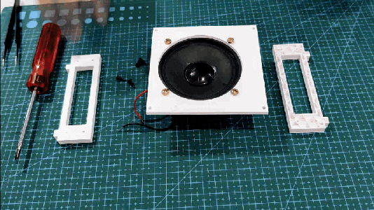

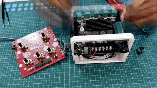

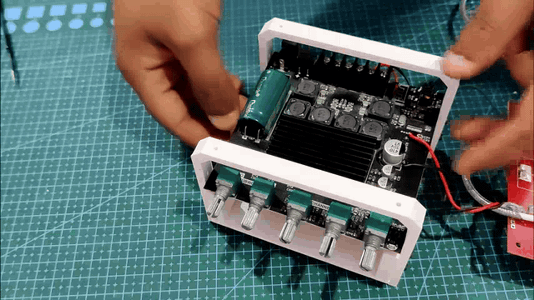

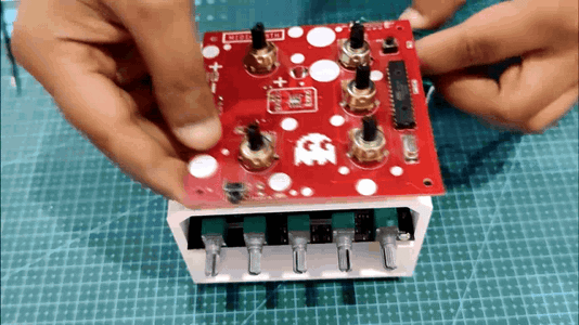

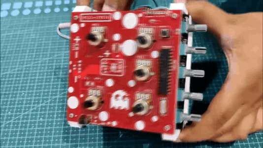

Step 7: 3D Design
In order to begin this project, we first prepare the 3D design, which is divided into three main sections: the speaker applied on the bottom side, the Audio AMP Module placed in the middle, and the Synth Board placed on top.
A designer's suggestion is to always model the components and raw materials before beginning the CAD process. For example, if we are using a circuit in our project, we must model it before building the housing or body for it.
First, we had to model the speaker, audio AMP module, and synth board—the three major parts.
After assembling the speaker holder, which supports the speaker upside down, we added two more parts to it, which will support the PCB for the audio amplifier module in the center.
In addition, we have two holders that are mounted with the mid-circuit holder portion on the left and right sides. The synth board will be held in place by these two holders from the upper side.

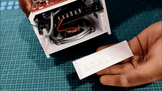

For aesthetic reasons, we eventually added a name plate to the rear.
The STL files for each component were exported after the model was finished, and white PLA was used to print all parts using an ENDER 3 with 0.2 mm layer height.

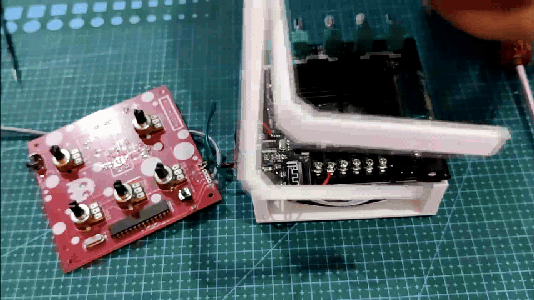

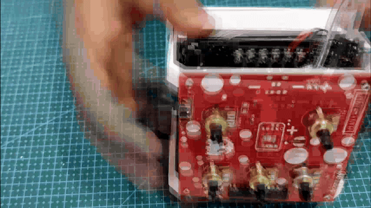

Step 8: Wiring
The wiring process is straightforward. To power the synth board, we first connect the GND and VCC of the Audio AMP Module to the GND and VCC of the synth board.
Next, we connect speaker to S+ and S- of the Audio Module
Finally, we utilise a 3.5mm cable and link the GND of the cable to the GND of the atmega328PU MCU. The L+ and R+ of the cable are connected to the D9 of the atmega328PU, which is designated as an audio pin in the code.
After soldering, we uploaded the sketch to the Atmega328PU and tested the arrangement.

Step 10: Speaker Holder Assembly
We upload code into the Atmega328PU, test the entire setup, and then we start the major assembly process. Four M3 nuts and bolts are used to attach the speaker to the base mount.
Step 11: MID Section Assembly
  • Four M2 screws are used to attach the mid-circuit holder components to both sides of the speaker base assembly once it has been prepared.
  • The Audio AMP Board is then positioned and fastened there with four more M2 screws.
  • Now that the speaker and audio AMP module are back together, we attach the speaker's positive and negative terminals to the audio module's S+ and S- terminals.

After connecting the audio AMP module and speaker, the synth board is the only thing left.
  • First, we use four M2 screws from both sides to attach two synth board holders to the holder of the audio AMP module.
  • The synth board is then positioned onto the holder and fastened securely in place with four additional M2 screws.
  • Finally, we use four M2 screws to fasten the noise box name to the rear of the box.
The noise box assembly has been completed.
