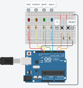

Step 1: LEDs and Buttons
First, we have to assemble the LEDs and buttons as shown. The blue LED will later be replaced by a piezo buzzer (or another noise-maker per your choice)
The buttons will act as "admin tools" to help us with testing the machine.
The code below shows how to set up the LEDs and Buttons for how we will use them. "SwitchState" will make sure that the action happens only after we let go of the button, to ensure that the action will only happen once per button press.

Now it's time to build everything with a physical arduino, and add your sound module. Connect the module as shown (a jumper cable from A0 on the module, to A0 on your arduino UNO, a cable from G to GND and a cable from + to 5V)
You can also swap out your alarm LED for your buzzer at this point. The code can stay the same, but I recommend changing the variable name to something along the lines of "buzzer" or "alarm" to avoid confusion.
