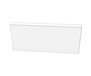

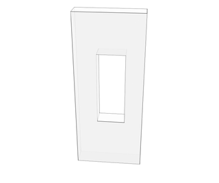

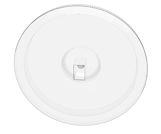

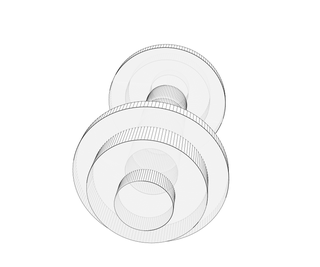

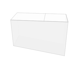

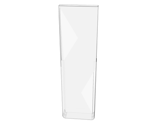

For now, there's a number of parts to print.
Step 2:
Use a couple of the printed "frames" to hold the motor. The wheels should screw into the plastic axle using 2-56 machine screws.

The front and rear connectors must be glued (or melted to the frame pieces).
Step 4:
The rear wheel is held in place with the axle holder (I melted this to the frame using a soldering iron).

The "shell support" was melted to the frame. Velcro was stuck to the top of the support (one sticky side to the "shell support" and the other sticky side will push to the "engine shell.")
Step 6:
To the back of the engine shell, I added the "hitch," which is designed to fit into the coupling mechanism of the particular coal car I am using.
