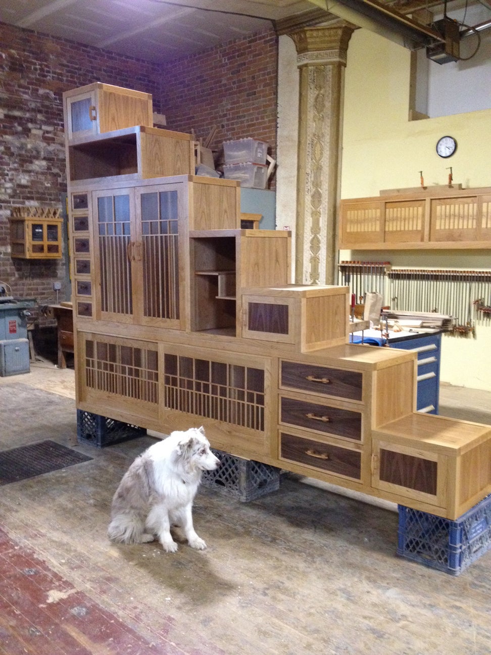

The largest single piece of furniture I’ve ever made is this stepped cabinet.  Finished piece is 8 ½’ tall and over 10’ long.  This project has been great, although it almost fell over on top of me at one point

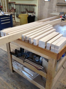

3. Back in the shop, I cut down all the rough boards except for one, which I made the longest members with.  Then I straightened one face and one edge of each board on the jointer and then sent them all through the planer to get even and consistent thickness of 1 13/16”.
4. After that, I ripped all the boards on the table saw down to 1 13/16” squares and sent them all through the wide belt sander to achieve even 1 3/4” square stock.
5. Then I carefully calculated a cut list for the stock and cut all parts to length on the table saw.

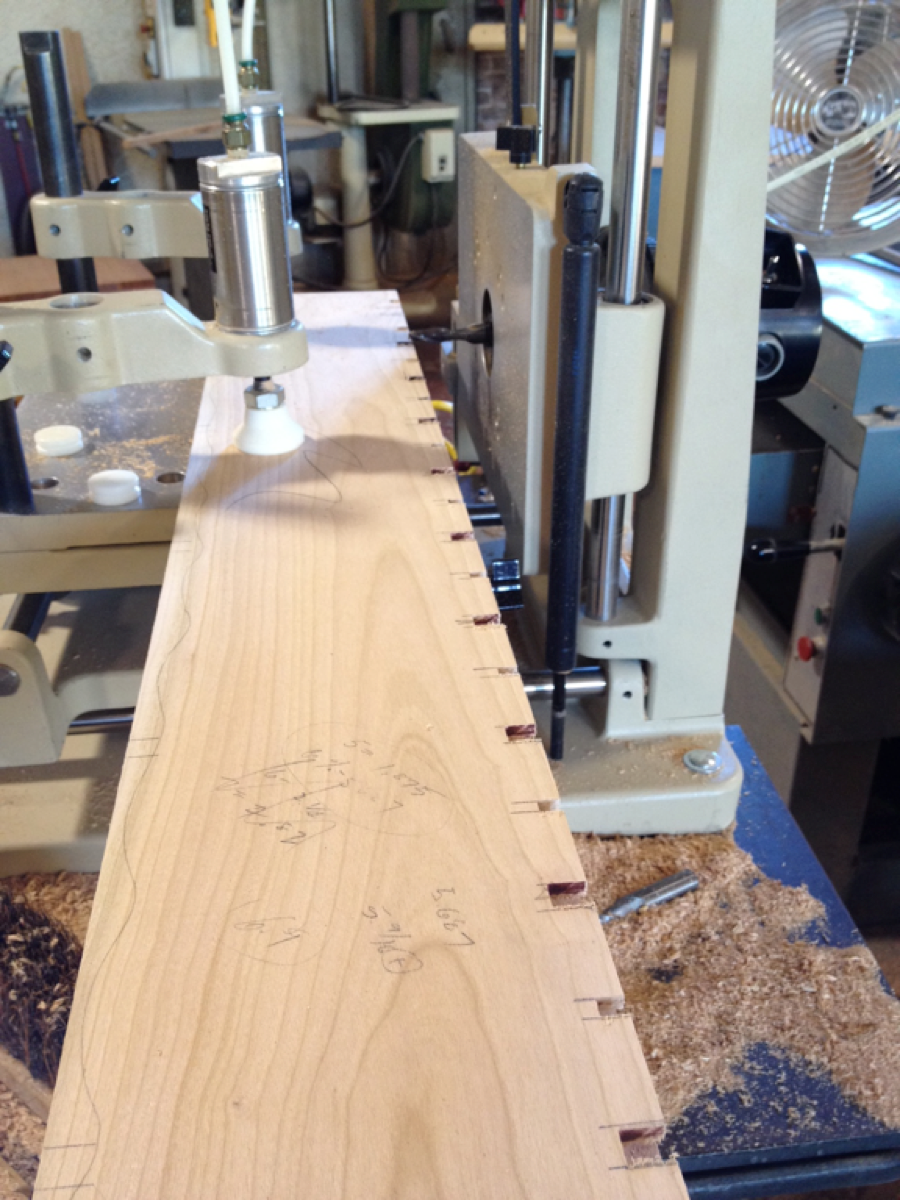

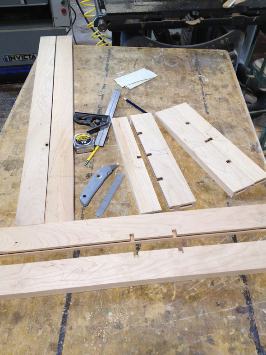

6. Moving to the horizontal mortiser, I carefully set up an exactly centered mortis in the stock and begin cutting mortises in the ends of all the short pieces and then on the longer pieces, I took time to lay out the mortise location.

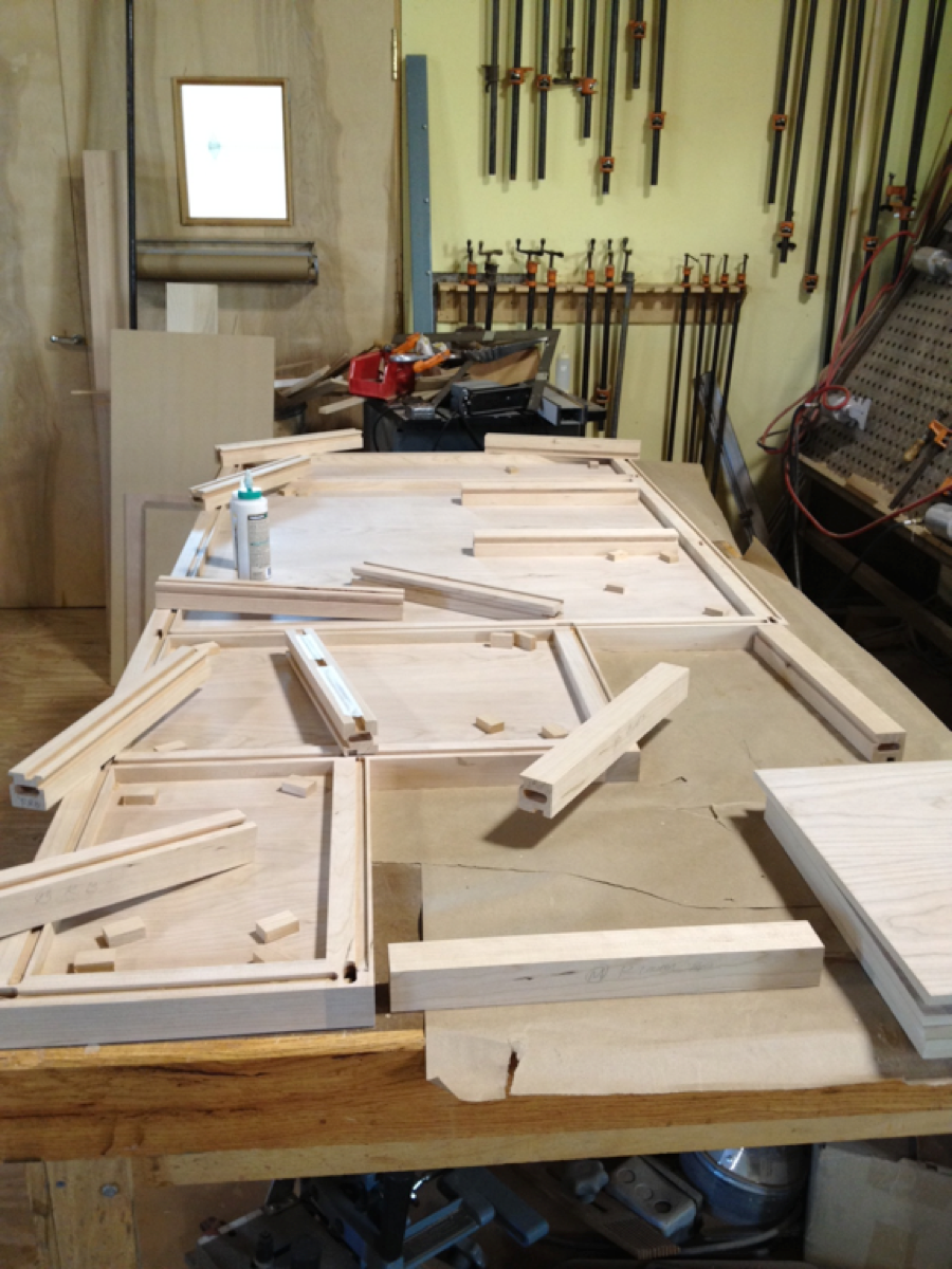

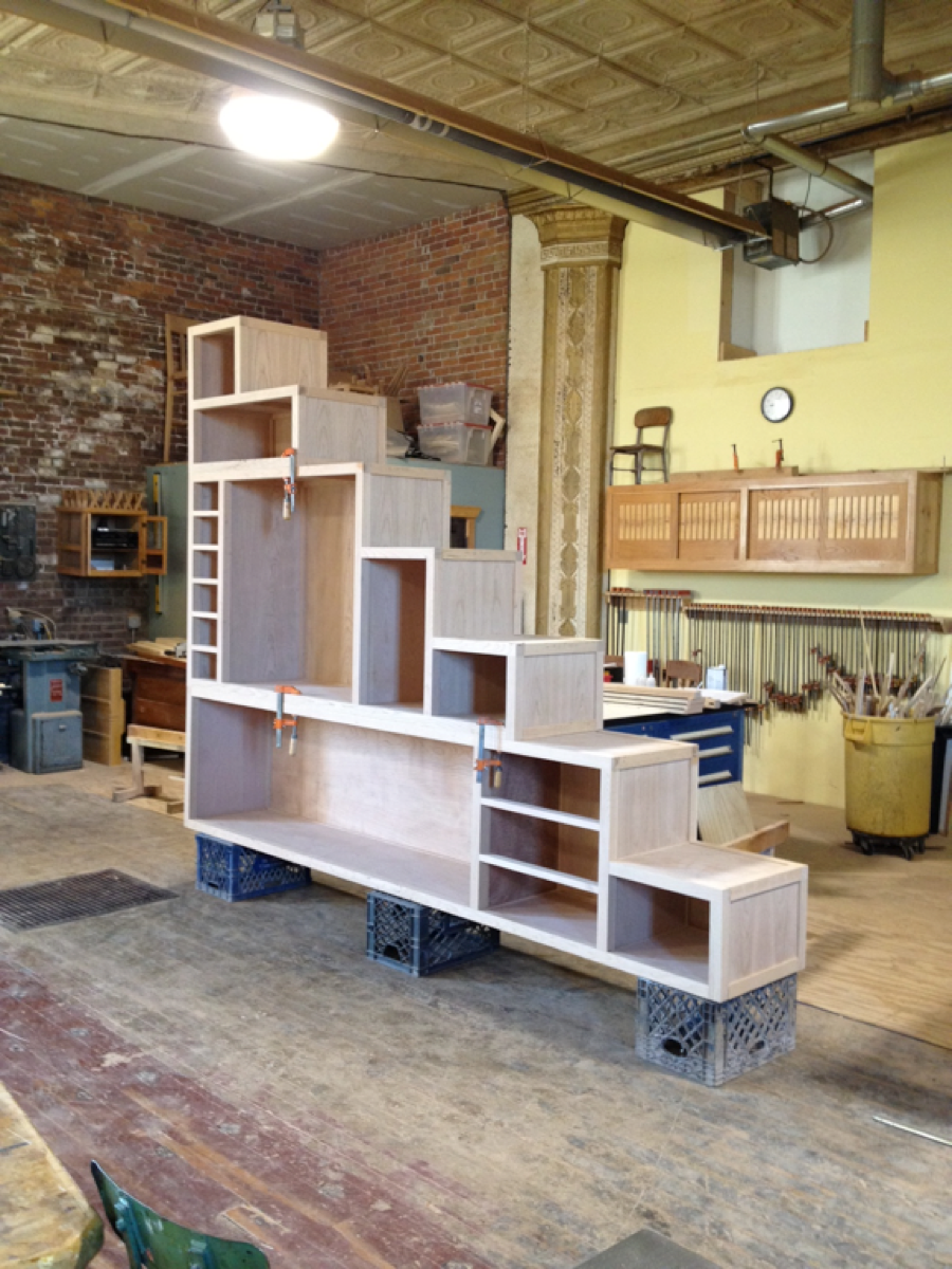

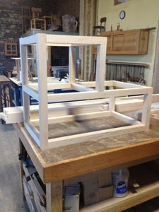

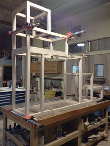

7. Once all mortises were cut, I dry fit the carcass to see the shape of things to come.

15. I made some ½ loose tenon stock and sized them to fit the exact width of the mortises.  Then I set a stop on a miter gage and cut a enough for all the front and back mortises.  I cut them 1/8” shorter than the combined depth.

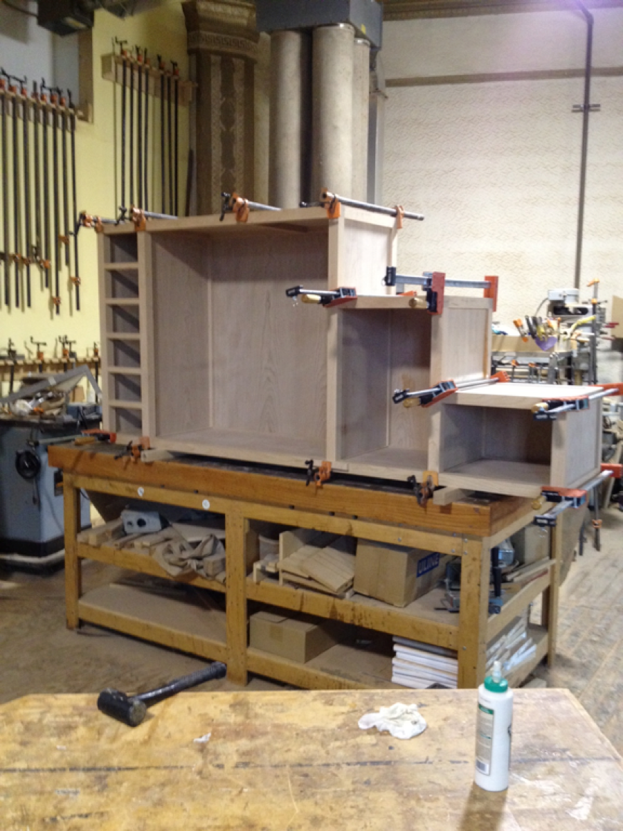

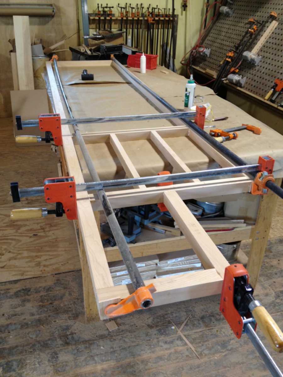

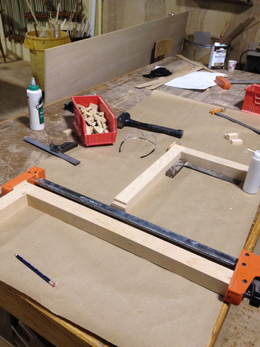

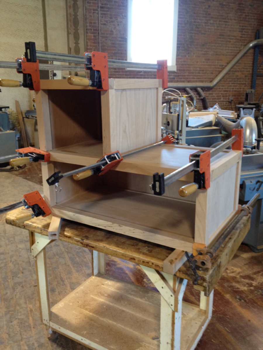

16. I then glued the front frames together.  I choose to do this in stages when possible.  It’s nice to be able to just have a few elements to have to control and square up.  As each element is glued together I take careful care to check for squareness.  Tight and straight work is imperative at this stage.
Step 4: Glue Up
17. I measured off the front frames for the sizes of the back panels.  Adding for the depth of the dados, I cut the panels starting with the largest ones first and took care to choose pleasing grain placement.   Then, I finish sanded all panels to 220 grit and eased all the edges.  This is important to avoid chipping the veneer during construction.
18.  Next, I glued up back panels.  Now it’s coming together!
19. For the last time, I dry fit the cases together and measured for the missing panels.  I sized and sanded all panels taking careful care to label the riser and tread panels to keep them in order.
20. I sanded the front and back frames, preparing for the big glue ups.   I took an extra minute and ran some 180 grit along each dado.   This helps the parts come together when the heat is on and the glue is setting.
21. Now I gathered clamps, a couple of glue bottles, some rags and a rosary.  I cleared the workspace and carefully laid out all the parts needed and devised a plan for applying glue, inserting tenons and panels as smoothly as possible.   At the start of your glue up, take a deep breath and get going.  If all goes well – congratulations, if not pull it apart.  It’s not worth getting it wrong.  Take it apart, wipe off the glue and try again the next day.

26. Then, I cut mortises in all the necessary joints – this should only take one setup on the mortiser.

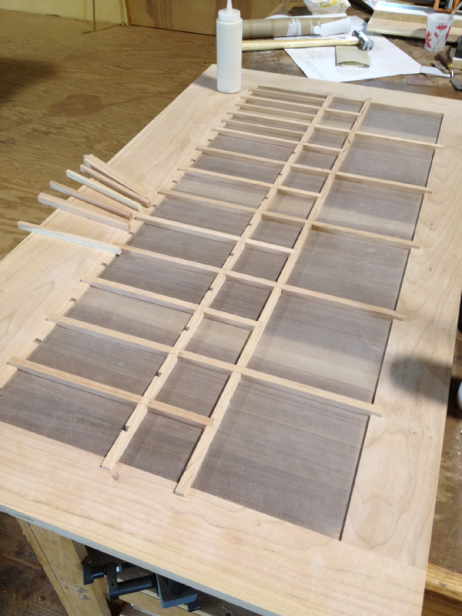

30. Using a calculator, I devised a symmetrical layout for the decorative latticework.
31. With decorative lattice strips prepared, I created ‘layout’ blocks to help evenly space the strips. I marked all joints with a pencil and cut on a mortising machine.

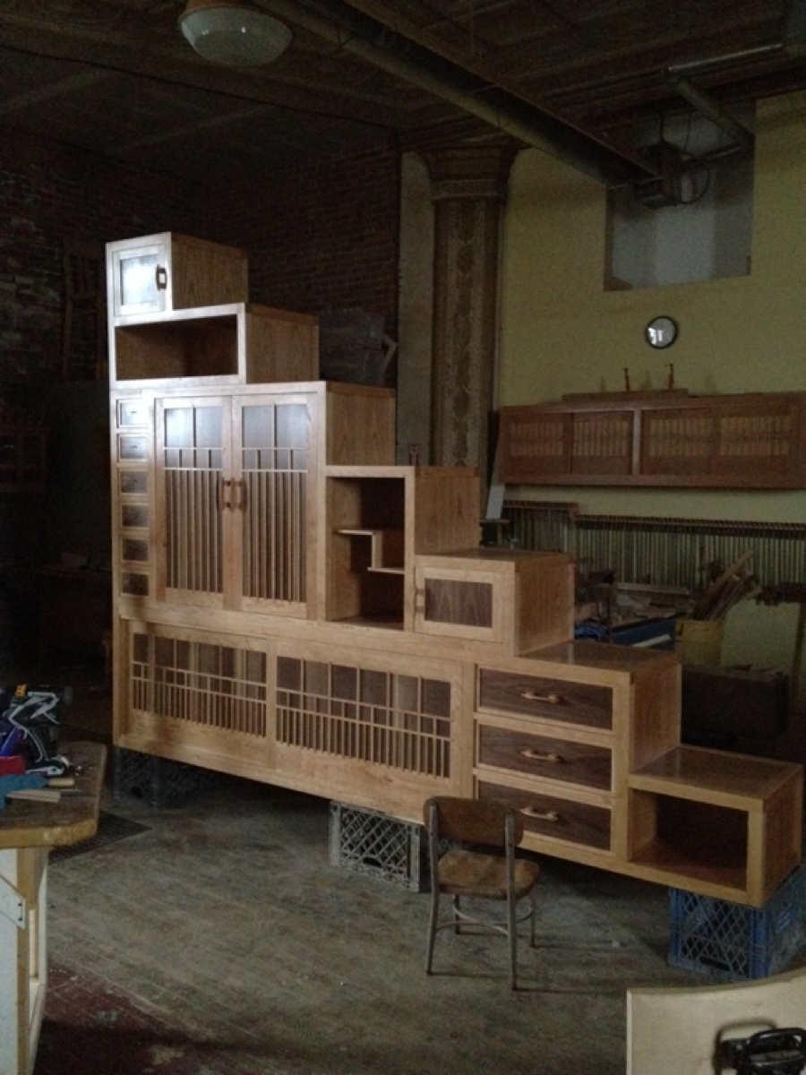

36. I attached the door hardware into the cups and placed the doors in the stepped cabinet. Are you still with me?
37. Then I made adjustments for even spacing for optimal 1/16” reveal all the way around and smooth swinging.

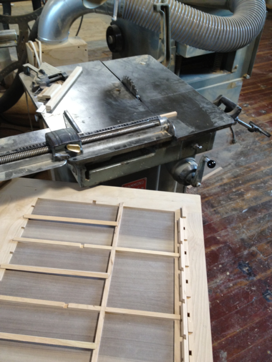

38. On to the sliders; I installed the decorative latticework of the sliders.  My first step was to size all the sticks, disregarding the need for joinery.
39. Then, in two stages, I marked for the joinery. First I installed all the vertical sticks at once and with a long straight edge and marked all the necessary dado’s.
40. I remove the horizontal sticks and repeated the steps above for the vertical sticks.
41. With a miter gauge on the table saw and my blade just coming out of the table, I cut all necessary dado’s, taking time to fit each one.
42. I glued it all together with the assistance of a little hammer.

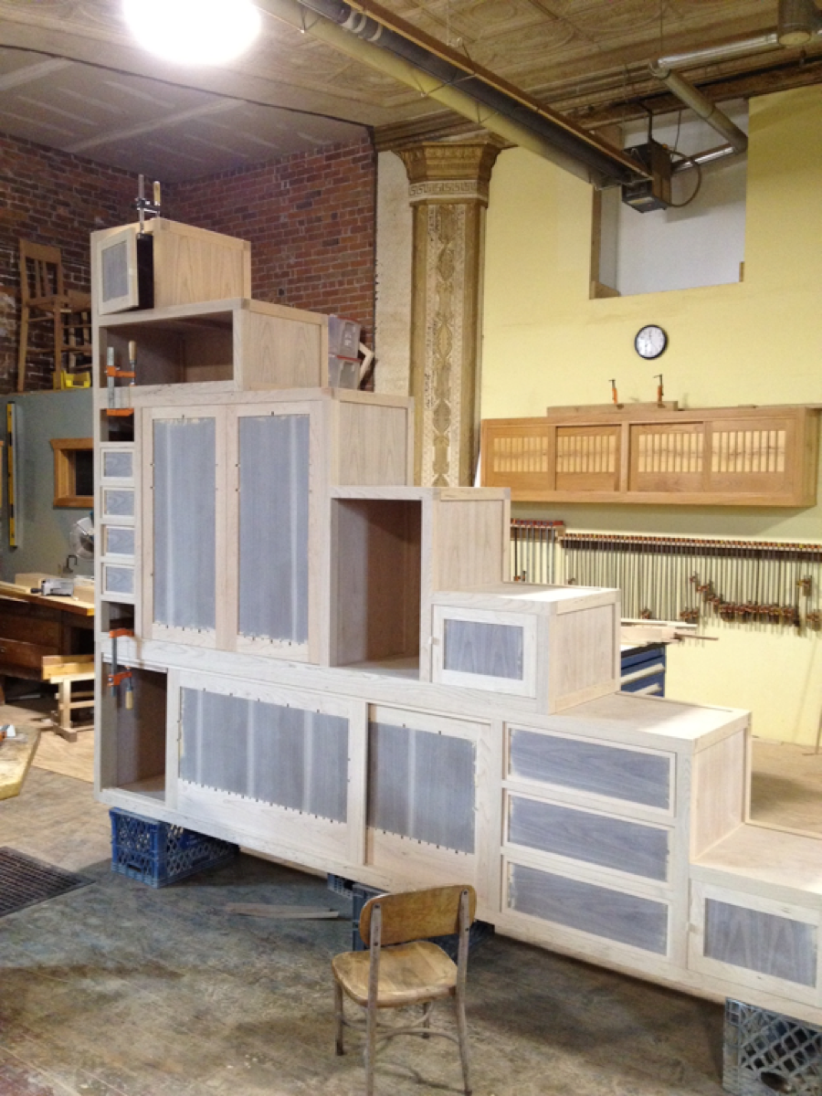

Step 8: Drawers and Finish Work
43. Then I moved on to drawers. I decided what size I wanted my drawers to be and sized my stock. I like ½” wall drawer boxes.
44. I cut dovetails (use whatever method you are comfortable with) and glued the drawers together. Then, I decided what kind of drawer fronts and handles I wanted. I fabricated, sanded and attached to the drawers after they’d been sanded.
45. After, I final sanded all my parts – case and all. For this, I suggest you wear your dust mask and turn your radio really loud, this step is going to take a while.

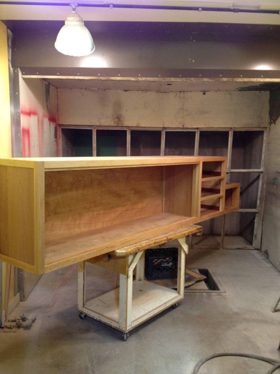

46. Time for finish work. I chose to spray all my parts. You may choose the same or to oil. As with all steps, take your time here. Any piece of furniture is only as good as the finish that you put on it.
