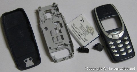

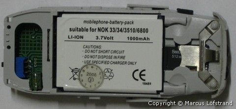

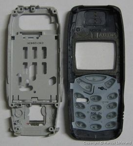

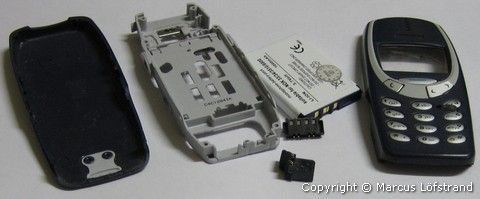

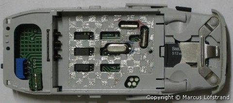

Step 2: Dismantle the Phone
Begin to dismantle the phone and reuse the part you need (shell, frame, battery, buzzer and battery connector).

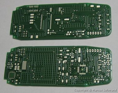

Step 3: Make Some PCB:s
Make the PCB:s your self or let a "Board house" do them for you.
The file for the PCB:s are right here:

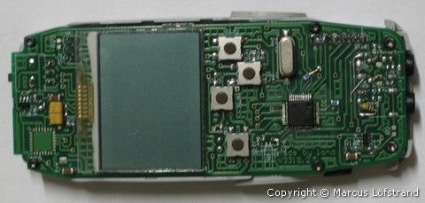

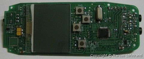

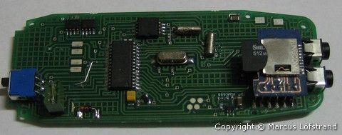

Step 4: Finnish the PCB:s
Solder on all components on the PCB:s and make some modification :( .

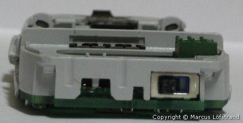

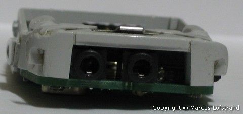

Step 5: Mill and Drill
Mill and drill the shell and frame to make room for everything new :)
Step 6: Reassembly

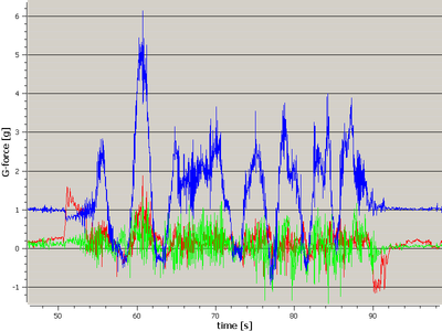

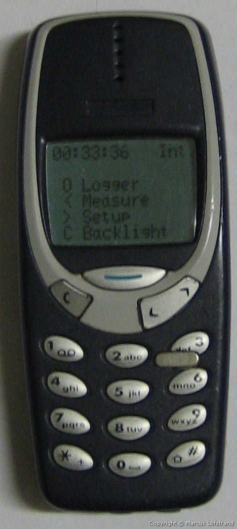

Reassembly the unit again. Make sure that everything fits. And finally, connect the battery and program the unit. The software is not really completed, bugs to fix :(

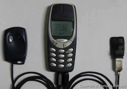

Step 7: Testing
Now we can test the unit.
