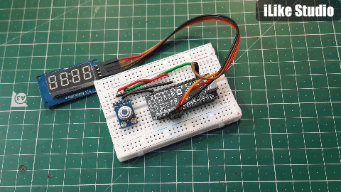

Step 1: Story
I made a project using non-contact temperature sensor in past, and in this tutorial to reduce the overall display cost, I had interfaced the sensor with 4-digit 7 segment display. The basic idea of measuring temperature remains the same. Just make sure to read the “non-contact temperature sensor using Arduino and mlx90614” to get a brief introduction about calibration components used. This project is sponsored by PCBWAY.com

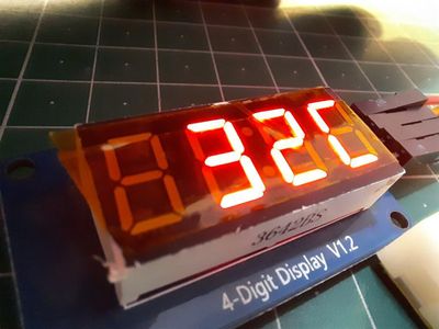

Step 2: TM1637 Display and Controller:
This 4-digit display is controlled by an integrated circuit named as TM1637 developed by titan microelectronics. Here I have some info directly from datasheet- TM1637 is a kind of LED (light-emitting diode display) drive control special circuit with keyboard scan interface and it's internally integrated with MCU digital interface, data latch, LED high pressure drive and keyboard scan. This product is in DIP20/SOP20 package type with excellent performance and high quality, which is mainly applicable to the display drive of induction cooker, micro-wave oven and small household electrical appliance. Get more info from datasheet including circuit diagram and different programming modes.
Function Features:
Keyboard scan (8×2bit), with enhanced identification circuit
Luminance adjustment circuit (adjustable 8 duty ratio)
Two-wire serial interface (CLK, DIO)
Oscillating type: Built-in RC oscillator

Step 4: Circuit Diagram:
Both sensor and LCD work on 2 wire interface, Sensor use I2C communication which is connected to A4 and A5 pin of the Arduino. For the LCD clock and data, digital pins D2 and D3 are defined respectively. 9V battery is enough to power up whole the setup. Both LCD and temperature sensor works on 3.3volt.

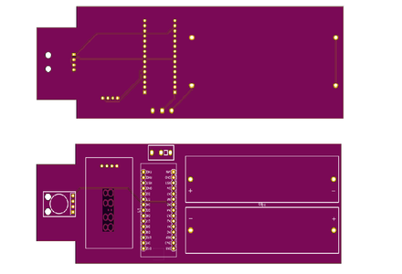

Step 5: PCB Shield:
I designed this shield according to the connection diagram. Just plug the Arduino, display and sensor at their place and we are ready to go after powering the system. Download the GERBER files directly from here.
18650 battery holders can be directly mounted on the pcb.

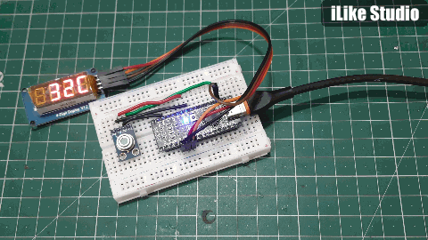

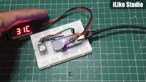

Step 9: Working:
Working very well with the Tm1637 driver, but need a reflector ion sunlight. Either use 5v supply to fed the LCD so that it would look brighter. I tested the highest temperature using my soldering iron. I2C interface is better than thermopile resistive interface gives great precision and easy to calculate also using inbuilt libraries.
