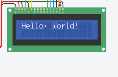

Step 1: Wiring
For this step, you might want to use the picture above. But some of the pins are self-explanatory.
Note: The resistor on the LED anode is 68 Ω, 100 Ω will work too.

Now, it is time to code our LCD. This shouldn't be too hard, since we are still using Adafruit's LiquidCrystal library. Below, I have linked a file containing our code, but you can copy and paste it from here.
Note: You're pins may not be the same as mine, if you wired it differently, I will provide a key to the pins below.
RS=Register-Select, EN=Enable, D4=DB4 (Rest of the D4, D5, is self explainatory)
#include <LiquidCrystal.h>
const int rs = 12, en = 11, d4 = 5, d5 = 4, d6 = 3, d7 = 2; // Replace with your pins
LiquidCrystal lcd (rs, en, d4, d5, d6, d7);
