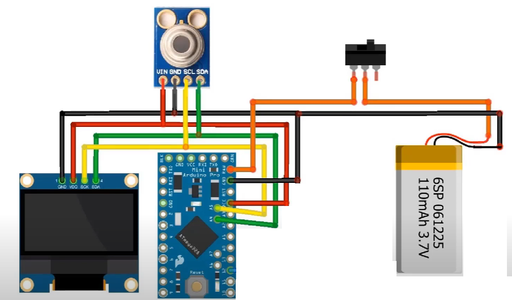

Step 6: Circuit Diagram:
Here in the circuit we are using very minimal components, A screen to print the readings, MLX sensor and Arduino as brain of this project. Arduino has SDA and SCL pins A4 and A5 respectively. We can connect both Led and sensor using I2C protocol to that SDA(DATA PIN) and SCL(CLOCK PIN). I2C can support up to 127 devices, here we have only two. All the circuit is powered by 5volt Dc.

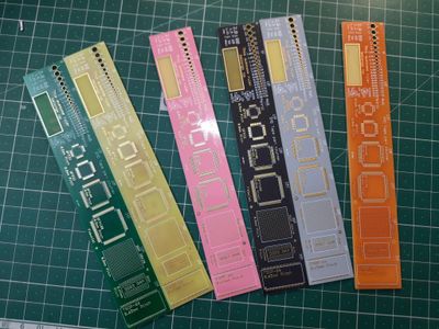

Step 7: PCB Layouts:
Keeping the size of project in mind, I designed a PCB. Here we are using Arduino nano chip and type c port to power up the whole system. You can also place a boost converter with 3.7volt battery. Download PCB files, Gerbers and schematics from here.
PCBWAY is the leading PCB manufacturing company for electronics hobbyists and project makers(students). PCBWAY is providing 5pcs of prototype PCB just in $5 and SMT assembly service from $12. You can checkout more, PCB, SMT ASSEMBLY, STENCIL and 3-D printed parts.
Step 8: Ordering Method:
My designed PCB is followed by PCBway prototype service, giving a professional looks to my designs. PCBWAY is affordable and best PCB manufacturer. If you want to use same designs as mine then get them from here.
For the professional looks, I am using PCB prototype service from PCBWAY. The ordering process is too simple, Sign-up to PCBway using this link.
Then choose the PCB size and other parameters of color, surface finish and material.
Add it to cart > Upload the Gerber files > CHECKOUT and get your package in just 7 days.
