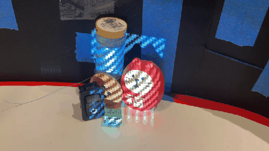

Step 2: Enclosure for Blocking Light
You will need to block out the ambient light. I used an Ikea stool and built up a wall of blackout paper around the parameter. Nothing beautiful, but enough to block the light. I then covered the entire setup with a black t-shirt. Cables ran through the back of the little home I built for the system.

However, there is a deeper theory called dual photography (Helmholtz reciprocity) at play. Try placing the detector at any position while keeping the object fixed. You'll find that the reconstructed image is always from the perspective of the projector. And the lighting on the object is as if the photodetector is acting like the light source. Like a little flashlight shining only on the side that the photodetector faces. The roles of the illumination and detector seem to be flipped!
In the examples above, I have three different detector positions. When I color code and overlay them you see them perfectly overlap.
Step 6: Non-line-of-sight Imaging
I really mean try putting the detector anywhere! The detector doesn't even need to be facing the scene. As long as enough light from the diffuse reflections of the scene makes it to the detector, you can construct an image of the scene from the perspective of the projector. It seems unbelievable at first, but when you think about it the paper is just acting like a diffuser in front of the detector. All we need to do is collect the light from the illumination pattern. It doesn’t matter if it’s scattered around before it reaches the detector.
In the example images above, I have the detectors from two positions. One is facing the scene and the other is facing a piece of paper. The reconstructed images are from the same perspective, even though the non-line-of-sight detector is noisier.

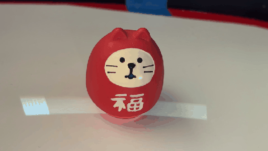

A few of my results are shown above: a number 5 and a cat object. I’ve always considered the Fourier transform as a pretty complicated operation that you only could do on a computer, so I thought it was so cool to physically measure it like this.

Finally, I wanted to try non-line-of-sight imaging using compressed sensing, so I moved the detector to face a piece of paper again. This seemed even more challenging because the illumination patterns aren’t spatially confined on the object.
But look at these reconstruction results from using the sinusoidal and Hadamard patterns! We get an image of the scene from the same perspective. Again, when you think of the paper as just a diffuser before the detector, it isn't too crazy to imagine this working. It just feels odd to have the detector facing away from the object of interest. Actually, the scene appears to be more broadly illuminated when reflecting off the paper, so we can see the wall behind the cat more clearly than when we have the photodetector facing the scene directly.
