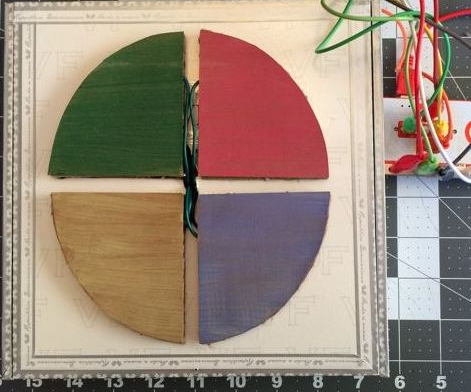

Repeat steps 3 through 5 for a second piece of different colored wire, poking the hole in the path and board parallel to the first. Label the back of the game board with the Earth marking and to which Key you want the wire connected on the Makey Makey.
Step 7:
Continue building copper tape pads for other game spaces. This board used four spaces, one for each of the arrow keys on the Makey Makey. Make sure you label the Earth and the key for each wire.
Step 8:
Select your playing piece. You can repurpose a small figurine or create your own. This “notbored” game used a 3D printed figurine made from a 3D scan of a garden ornament. The game also uses a repurposed LEGO Duplo figurine.
Step 9:
Turn the playing piece over. Affix a small strip of conductive copper tape to the base of the playing piece. Align the copper tape so when the playing piece sits on one of the wired spaces the copper tape on the playing piece bridges the two pieces of copper tape on the playing space. Alternately, use aluminum foil and the shape of the playing piece’s base to create the conductive “bridge.”
